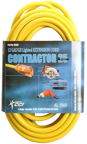

It's not me - it's for the home owners that I assist that like to drag their games around the garage/basement floor letting the cord get trapped under the leg levelers. And for the guys that like to lay their cabs on their backs in a pickup truck as the cord slides around under the weight of the cab and gets mangled in the process.
And I don't know where you're finding a 12 gauge cord.
Here's a 12/3 extension cord on Amazon:
http://www.amazon.com/Coleman-Cable-25-Feet-Outdoor-Extension/dp/B000BW3LNA
Ah. Good to know. I was actually looking for one this last weekend, since I melted a 14 gauge appliance cord by using it to power my server. Lowes didn't carry anything 12 gauge aside from one air conditioner cord, and it had a funny non-standard plug on it. I really need an extension cord, about 6 feet long, that can handle 20A. That one is way longer than I need, I'll probably just make one.

12 gauge power cords are pretty commonplace at Walmart, Home Depot, etc... They are usually advertised as Heavy Duty...
