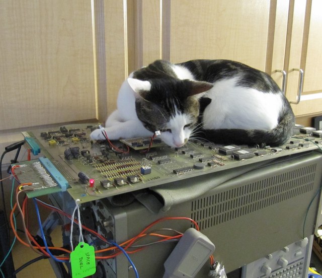

This one's been very effective...
You can see she'd ID'ing a bad IC
My cats have proven to be of no help in troubleshooting. They do a good job of keeping the mice out of the basement in the wintertime :)
