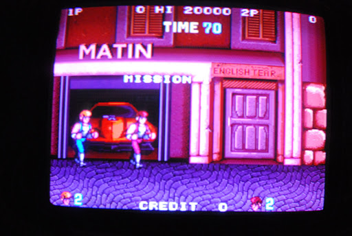

I am pretty sure its a WG K7000 but I am not 100% sure. The picture is not as crisp I think it needs a cap kit but before I order I want to verify. Pics are below.

Awesome thank you. So usually when you have a working picture but its light and faded will a cap kit more than likely fix this?
25" k7000 shelf mount. Probably an offroad.
Dim pic is not caps, the tube needs rejuv or its just gone.
Caps if its light and dark on both sides or if its in shutdown. White knobs on the flyback, so you should consider replacing it(Or buying a replacement when it does go.).
Monitor chassis looks like its been capped once already. So recapping might not be needed. I always write the date I capped a chassis on its side. I also mark if hot, fly and reg have been replaced.

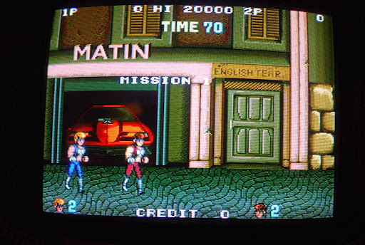

Here is a pic to show what it looks like. See its not bad after adjustments but just not crisp.

Eeech...your coarse brightness (bottom knob on the flyback) is too high. Back it off a bit and see if that makes your colors look a bit better. I understand that this will make your entire image a bit dimmer, but you should get better color balance that way.
Yes, the tubes used on the 25" Wells monitors can benefit greatly from a rejuvenation.
