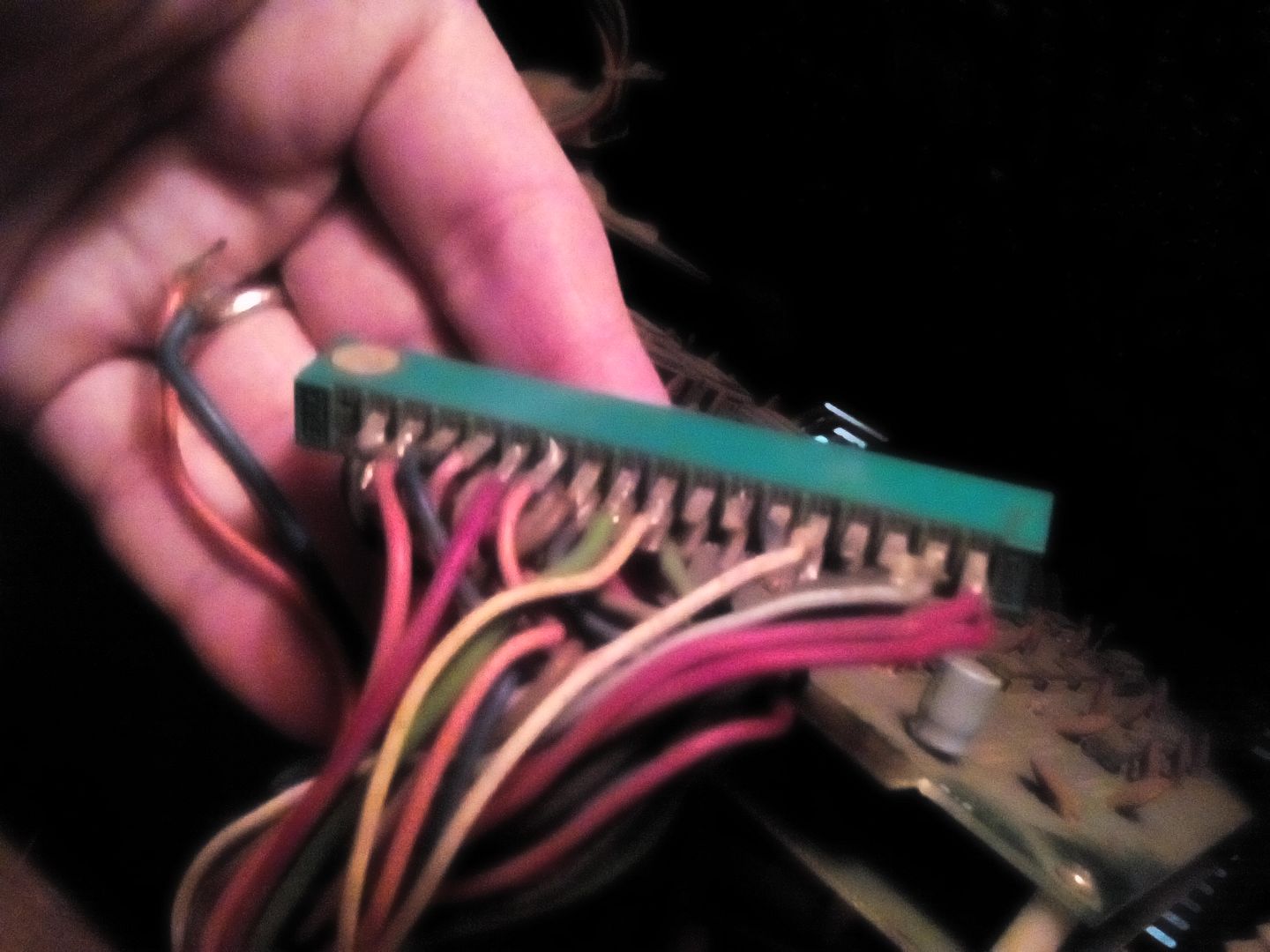

I have a question. Could you take a Better Photo of your Harness connector? Like right from the back side where all of the wires are.
I have a feeling the 2 wires you have broke off are A1 and B1
A1 is +12 Orange
B1 is -5 Blue
Looking at your first photo it looks to me that there are 2 broke off connections on the far left side of the photo. But I want a better pic to be sure.
And IF the Blue IS B1 -5 you will see some readings back at the power supply.
Here's what I'm working with.
It looks to me like you have, going from bottom near fuse, Ac, Ac, Fg, -5, +12, gnd, and +5. Also looks like the +12 terminal is under that cap.

Here's a close-up of it. You can see that at the 10th and 11th pins in from the left, there is a little bit of solder. That's why I was thinking that those wires came off of those pins.
So should I pop orange in A1 and blue in B1? On closer examination, the pins are still soldered to the wires. I hope that I don't sound too clueless here; I just don't want to do anything dumb.
Be CAUTIOUS to know where A1 and B1 are at. If you get them upside down you will Fry shit.
I would "think" A1 would be the Parts side of the board and B1 is the Solder side, But before you Just "do it" Please get conformation if I am correct or not.

The parts side of the harness shows numbers, and the solder side shows letters. Thus, "A" is on the bottom of the harness:
12
AB
So, "1" and "A" are the unoccupied slots.
Any advice? I have an extra board, in case anything fries.
Nobody wants you to take a gamble and fry a perfectly working board.
You need to be sure before you power anything up.
The back of the Harness Should be labeled, and even if it is not, look at the Schematics for the game find the next wire over to the one you think is A1 (Should be A2) and see whare it leads in the harness. if it matches you have your position.

Here is a link to the Schematics for Scramble. Look at Page 8 for the harness pinouts. It is top left side Looks like a bunch of Long Circles with numbers.
Looks like A3 is P1 Shoot But I think it should read P2 Shoot 1 (May be a typo) A4 is P2 Left. So if you can trace those 2 wires to one side of the harness You Know for sure where A1 is located then, its on the same side.

Here is another piece of the puzzle: Those slots are totally empty on the other side of the harness. There is no metal connection at all. It's just vacant space.
