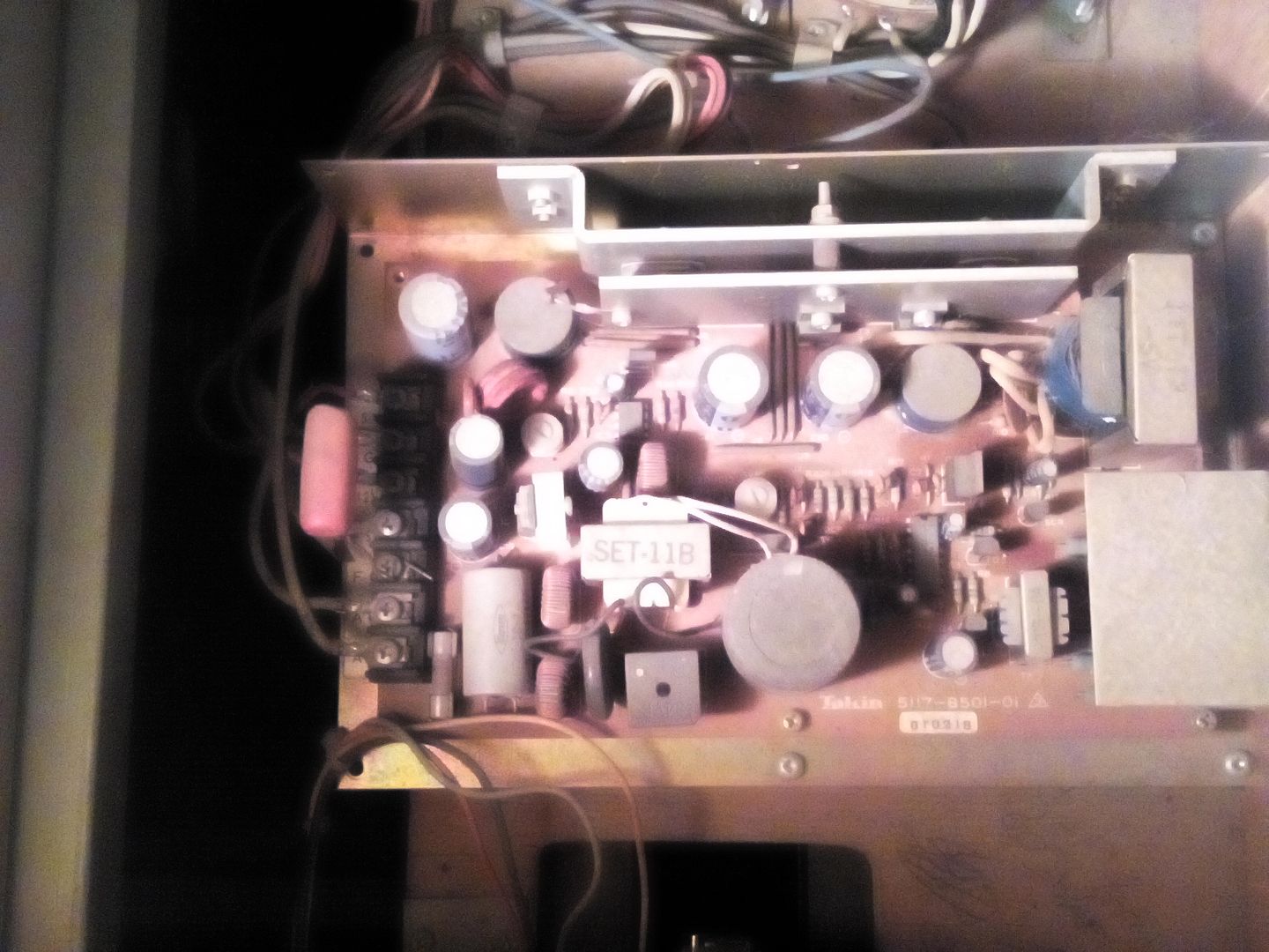

I'm getting absolutely nothing on pin 1. I used the monitor frame for a ground, and got readings from other pins. How do I know if it's connected to 12v on the power supply? I do see a 12V on the power supply, and it's occupied with a pronged wire, screwed in.
Is that terminal marked 12v ( circled in red ) ?
If so measure the voltage between GND and 12V on the power supply ( be extra careful ).
You should also check that the wire from pin 1 on your harness goes to that terminal ( 12v ) on your power supply. It might have come loose or is dirty and not making the proper contact. Or the 12v is completely dead from the power supply itself.

All you need to do is now is follow the wire from that terminal to pin 1 on your harness and make sure its connected.
EDIT: Oh, snap! It looks like the orange wire that wasn't connected to begin with! (See first pic.) Do I just solder that to the ground on the harness?
It's easier if you set your DMM to continuity ( diode mode ) and connect one end of the DMM lead to pin 1 on the harness, and the other to the 12v terminal on the power supply. With the machine off of course.
It is showing a readout when I do that. It's a large number that disappears quickly. I edited my last post; did you see it?
