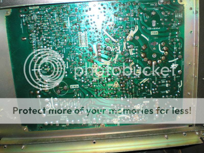

Built in 1982. Has wierd video connection, instead of:
RED:GREEN:BLUE:GROUND SYNC
its
RED:GROUND:GREEN:GROUND:BLUE:GROUND SYNC
Thanks
Robert
His pics are gone.. Was it ever ID'd? Mine works, but installing an unknown monitor makes me feel icky.
I never did nail it down, but I'm thinking Ken may have been right. It didn't match any Mr. Do schematics I have, but there may have been other variants.
What leads me back to it possibly being from a Mr. Do is the screen burn- it looks a lot like Lady Bug, and Do's where frequently converted to Bugs....
Good luck.

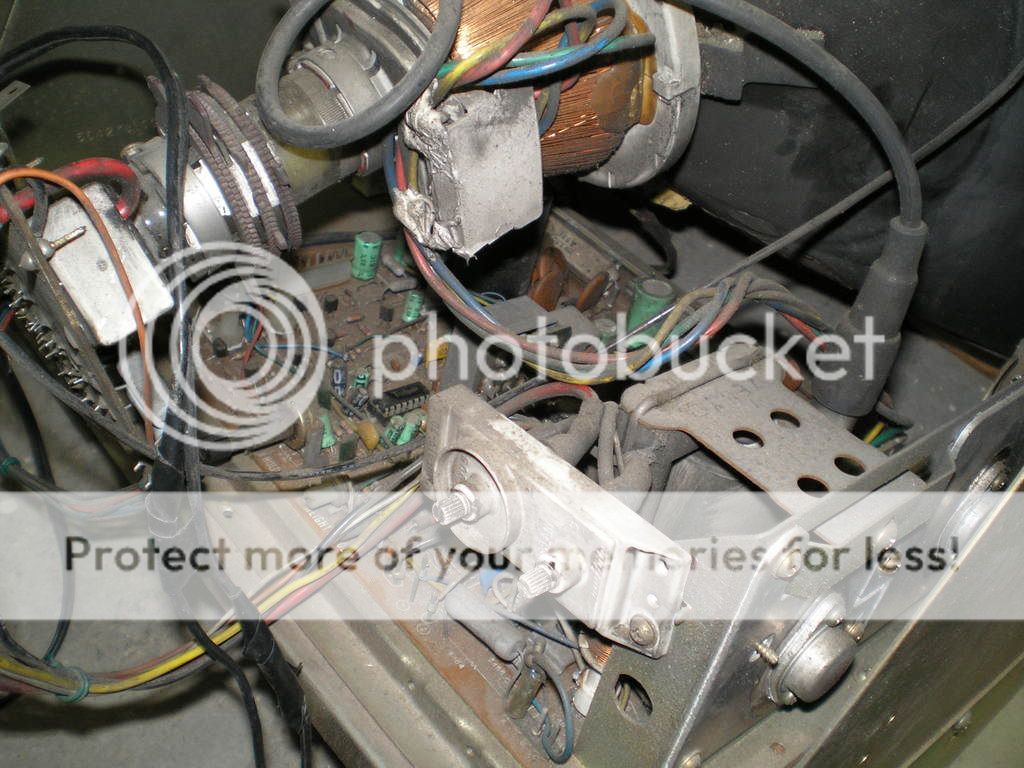

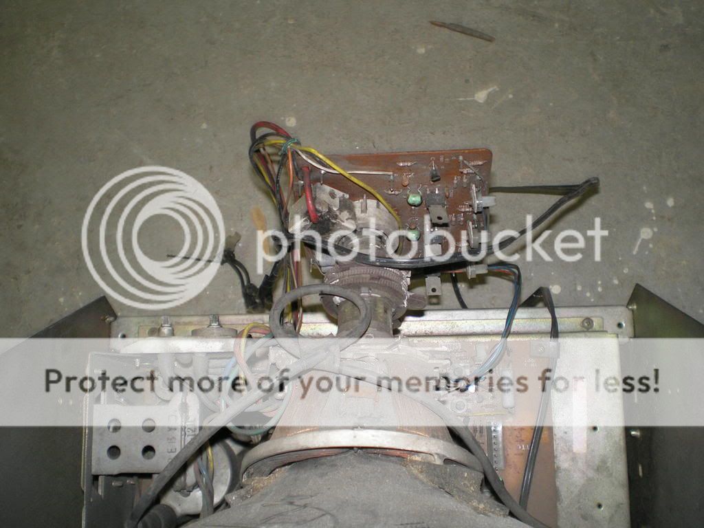

i have one a shot of these; came out of my Springer converted to a Ladybug. i'm still debating if i should throw it out or not.
it's an ATI monitor. i don't know if i can dig up the model number again, but i found a whole of maybe a half-dozen references to it through Google.
ah, here it is; i did save the tag. it's a CR-M-19VH.
