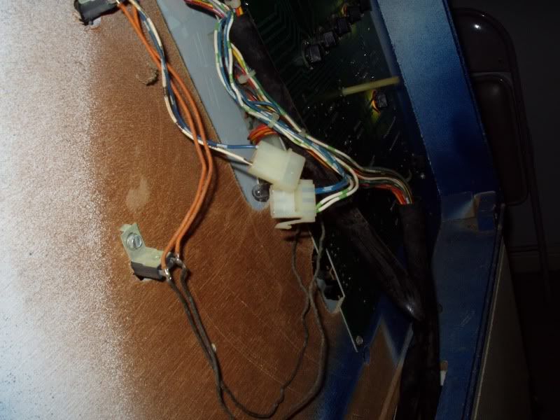

Your GI circuit has a blown fuse likely (GI = General Illumination). I'd look at your fuse block to start with... remove and test the fuses OUT OF CIRCUIT... If that doesn't work, you then need to look at your connectors...likely the GI circuit connector is burned to hell...it happens.

Thanks for all the replies. The lights on the playfield stayed on a few hours and they went off again.:confused:
Here's the connector I was talking about.

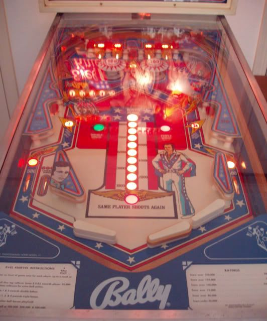

and got a photo in while the lights were still on.
