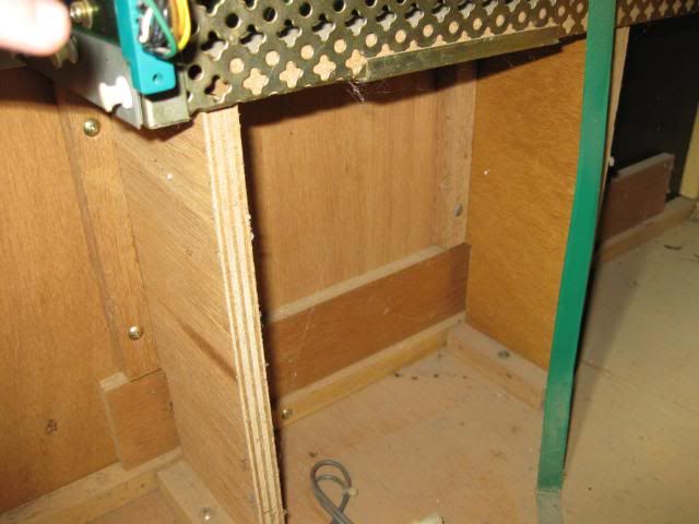

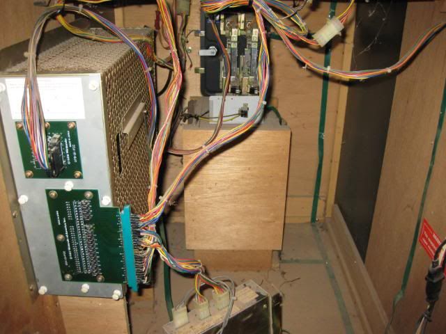

I just need a few pics of the inside of the cab from the back.

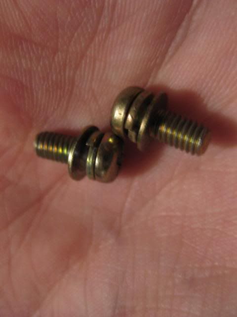

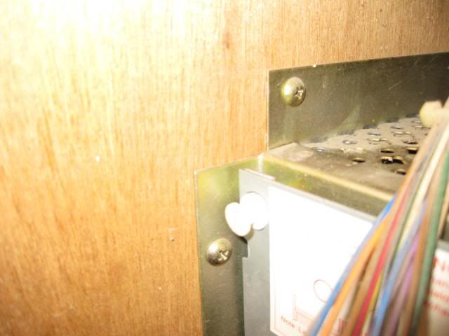

Exactly how the cage is mounted, and how the power supply is bolted to the cage. Mainly what the screws look like. Is the supply bolted?
Thanks in advance
Here's all I've got on my computer right now, can get more tomorrow if you need some. The power supply sits in that ledge on the cage and then two screws hold it in on top.
I just picked this one up yesterday. This is where the power supply is on mine, it's bolted to the side it seems.

Is the cage resting on the wood piece on the side of the cabinet? And are there washers around the screws?
I didn't realize the holes on the cage for the PSU were threaded, lol.

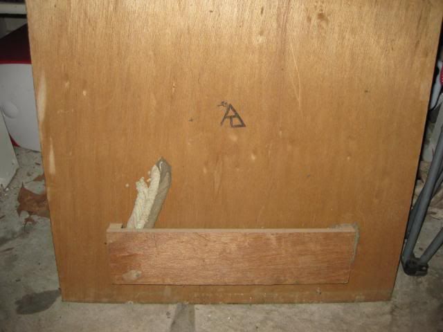

Now, I need a shot of the back door, from the inside, top and bottom parts.
I know I'm not going to get it 100%, but I hope I can get it as close to factory as possible
I've got mine opened up and in the garage right now. Can get pics of whatever you need.
Cool, I would appreciate it!
just what I listed before, really. I need a shot of the top and bottom of the back door. And I guess where the door meets at the top of the cabinet

The cage does rest on the wood:
The screws holding the cage on do not have washers:
Top of the door:
Bottom of the door (don't mind the wasp nests):
Here are the screws that mount the PS to the cage, they do have washers:
Edit: 8-Bit's PS is a bit different than mine, his looks like it sits sideways. Mine sits flat on the cage in those two slots, it's just not pictured as it's broken.
Pretty sure on mine the power supply is mounted to the side of the cage differently. See if i cant get a picture.
