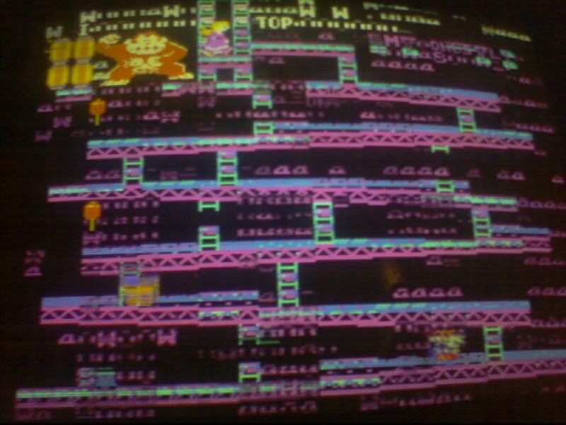

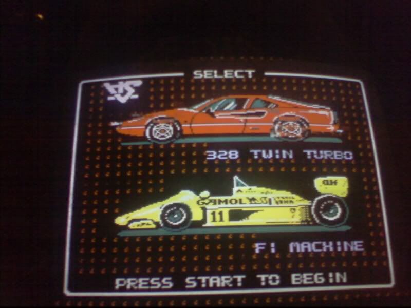

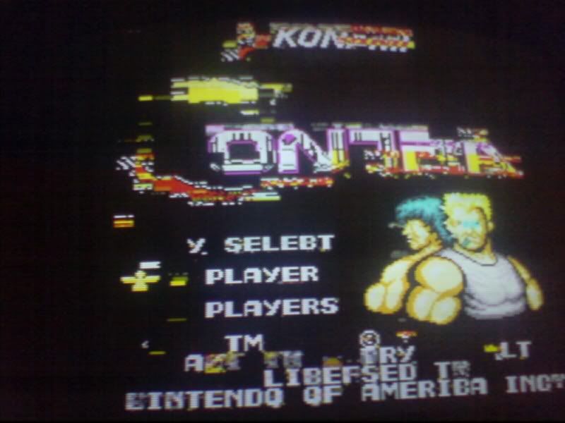

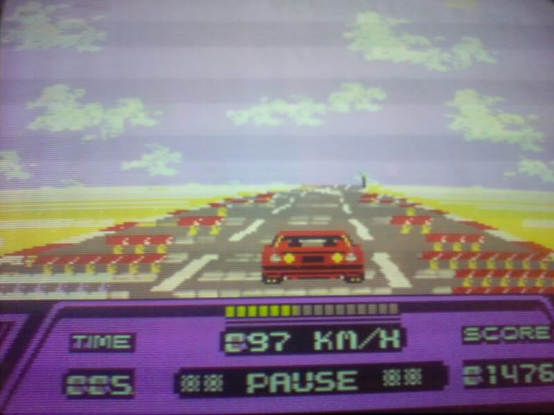

So, I had an arcade party for halloween and had the games all fired up for about five hours, two hours into it, I noticed my playchoice was getting garbage on the screen, but just during cycling through the game intros in attract mode. Sound was working, and the playchoice instructions were working, but when games came on, garbage. This was every single game. Is the board overheating?
It sounds more like you have a connector problem in the power supply. When the game gets hot the additional heat can cause failing connectors/components/solder joints to fail hard until they cool down.
Hmm...is that something that can be traced down easily? Or do I need an entirely new power supply? I dont run it that often, but if it runs for more than an hour, the glitching begins...suttle at first, and then badly
