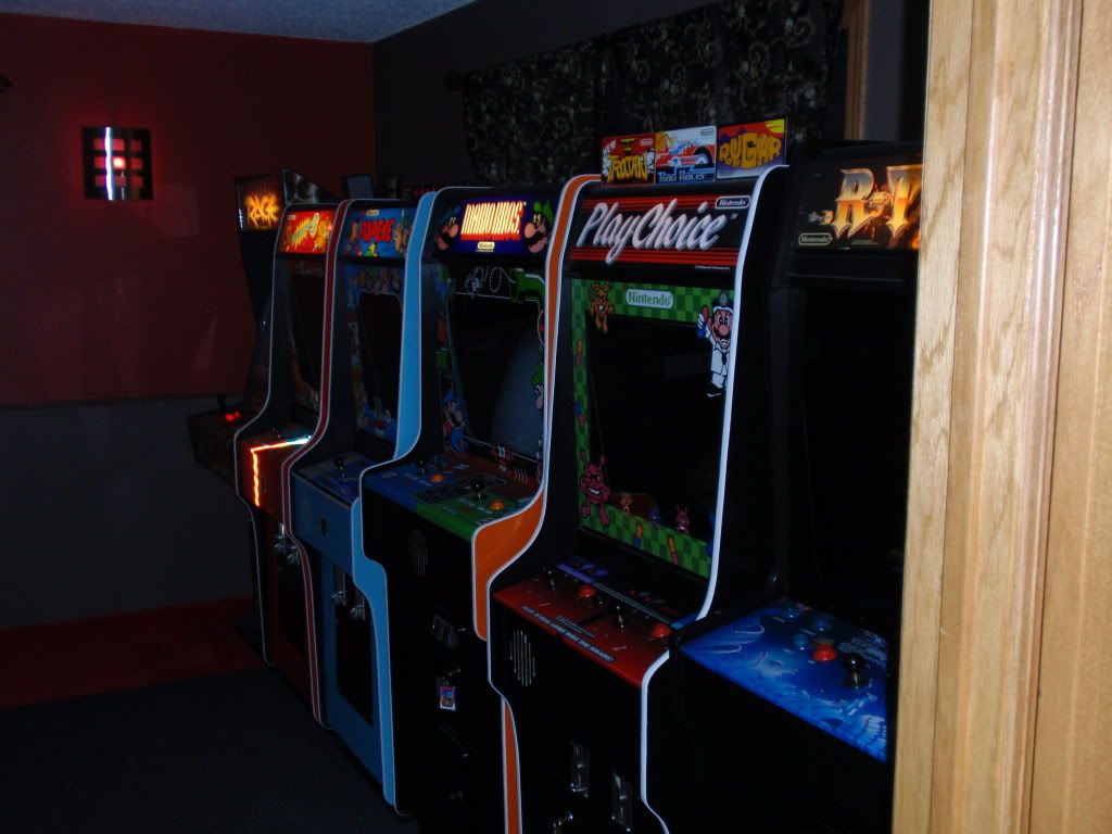

I'm new to owning the Playchoice and I was thinking of buying a few marquees. The only thing really stopping me is I'm not sure how to install one. Can someone tell me how, if someone could post a picture of their machine with the marquee I'd appreciate that.
That's what I thought but wasn't sure. So I'm assuming you just sit it on top the machine and that's it?
The marquees themselves are adhesive-backed decals. They in turn mount to aluminum L-brackets that get screwed to the top of the cabinet. There is a smooth face for mounting the decal, and a flange that sits flat on the top of the cab that has 3 screw holes for mounting to the cabinet roof. You can get no more than 3 marquees mounted side by side on the front side of the roof of a Nintendo cab. You mount the front edge of each just behind the marquee bracket.
