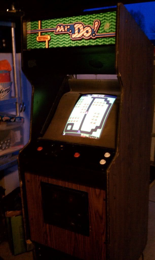

So I picked up this game that had been advertised for $200 for a couple of months and then for $100 for a month or so. I'd say the cabinet is about a 3.5/10. The bottom has some water damage and someone had screwed a couple of 1 x 4 on the bottom. The front of the floor was collapsing and the machine basically rocked like a rocking chair until the chewed up side panels touched the ground.
The monitor and electronics are perfect. One button is missing, but the game plays great with the other button and joystick. The cardboard bezel is saggy, but I can probably stiffen it up and paint it to make it useful. I had to replace the speaker panel above the monitor and I did that today after I stitched up the sagging cabinet with a couple of dozen decking screws. I screwed some levelers on the bottom and a new starter in the marquee light and this thing is now structurally sound and functional. The t-molding grooves are filled up with silicone adhesive and I'm not sure how I'll clear them out.
I'm trying to make this thing presentable without hacking it up any more than I have already so maybe instead of swearing at me and calling me names, some of you guys might be able to help me out a bit with a suggestion or two on how to make this thing presentable. For those of you who haven't cussed me out yet, thanks.

You will need a new CPO and to repaint the interior of the cabinet. The coin door will just need some cleaning, it's pretty good. The bezel can be reinforced with some cardboard. May as well get a correct Mr. Do! bezel, though.
The t-molding can be removed with a flathead screwdriver. Edit: Renegade beat me to it.

I made some progress yesterday:
Cleaned the silicone out of t-molding grooves and installed new with white glue and staples. I'll pull the staples out next time I work on it.
Put matching camlocks in the coin door and back panel.
Reinforced, painted and installed the cardboard bezel and installed tinted glass bezel.
Replaced the broken leaf switch with a micro-switch button I had.
Replaced the broken coin mech with a spare so now both coin slots are functional.

The next time you go to replace T-molding, it's a good idea to just bondo up the existing channel, then use either a dremel disc or the proper size router T bit.
Then you can avoid using glue and staples and do it right the first time.
Zinfer, I am aware of the right way to do things but I'm hampered by a lack of those things most scarce in my life - time and money.
