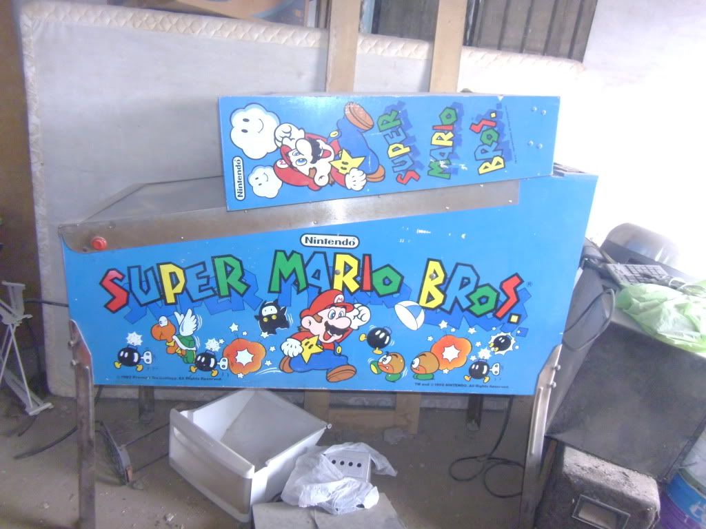

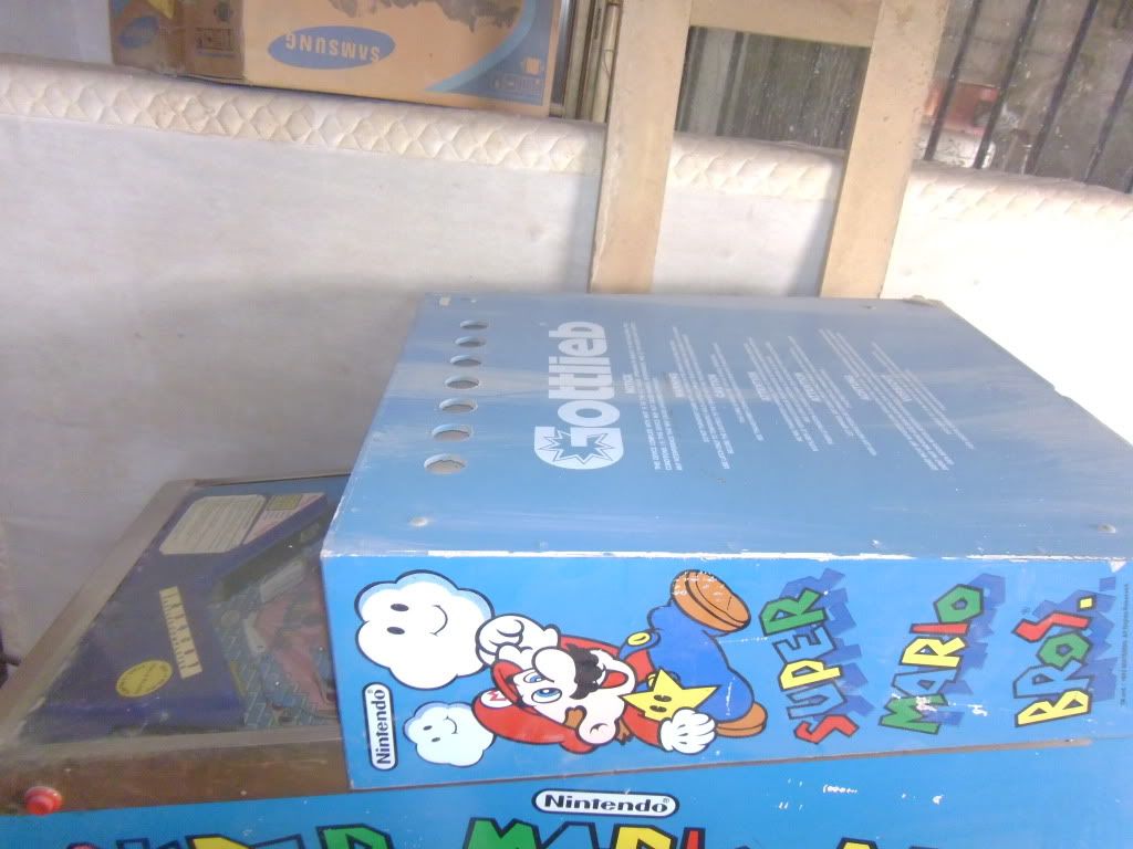

Well its a Super mario pinball. Artwork has some damage and that's all i can see from the pics. He just said its in great shape. At this point I'm not sure if the seller will even let me see it. He told me he had to move it from his warehouse to his house. And that he wanted to know if i was serious about buying it from just liking what i see. I told em im really interested but id have to see it to buy it. No response yet :/. Anyway thanks for the info.

$1800 is very, very high for a SMB pinball machine. These are normally $1000 or less, even when their condition is outstanding.
