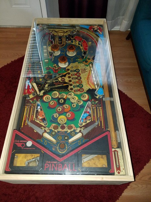

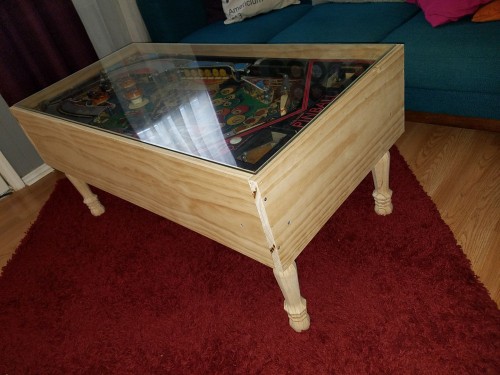

Built this new pinball coffee table for Galagatattoos (klov member) from a fully populated playfield I picked up (Saved) for him on my Texas Pinball trip earlier this year.
Will post pictures as an update when it is fully finished.
Still need to
1. Stain the wood
2. Glass trim
3. Corner trim
4. Tap into original harness with conectors and light it up (dc->ac buck convertor or swap with comet leds and just use dc voltage.
5. Eventual possible arduino with OPP/MPF for attract on the lights.
Playfield is a fully populated Eight ball deluxe , with new plastics from planetary pinball.
Still need to
1. Stain the wood
2. Glass trim
3. Corner trim
