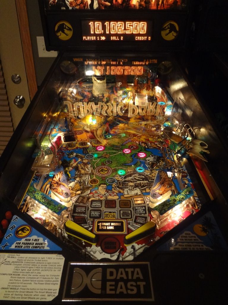

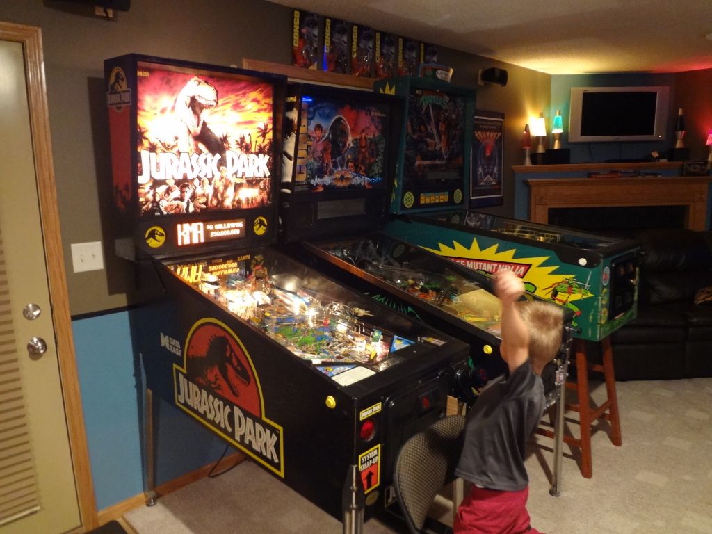

Well, technically it's pin #5, but my original two pins are now gone. Big thanks goes out to some KLOV buds (Thatguy & 30fathomdave), and pinsiders tonymiddendorf and The Postmaster for making this happen for me. I had been looking for a JP for about a year and a half. Every time I thought I had a deal secured, something would happen to kill it. I ended up contacting LesManley and grabbing his Congo, as I thought that would be the closest I'd ever get to owning a pin inspired by a Michael Crichton book. After getting my Congo home, I could think of no better pin than JP to put next to it, so I doubled my efforts. Well, I posted here that I was looking for a JP and was directed to Pinside. Within a week, I had a deal struck with local pinsider The Postmaster and picked my JP up last Sunday. Snapped a couple of pics of it in its new home. The last one is my son's arm raised in victory after I told him he'd killed the T-Rex. As you can see, I need the topper, so if anyone has one for sale, LMK!

The legs are out getting powder coated. It's now strapped down, no worries. It was the only way I could take the legs off and not have to put it flat on the ground. I tried asking for a set of used pinball legs over at pinside but no one responded.
