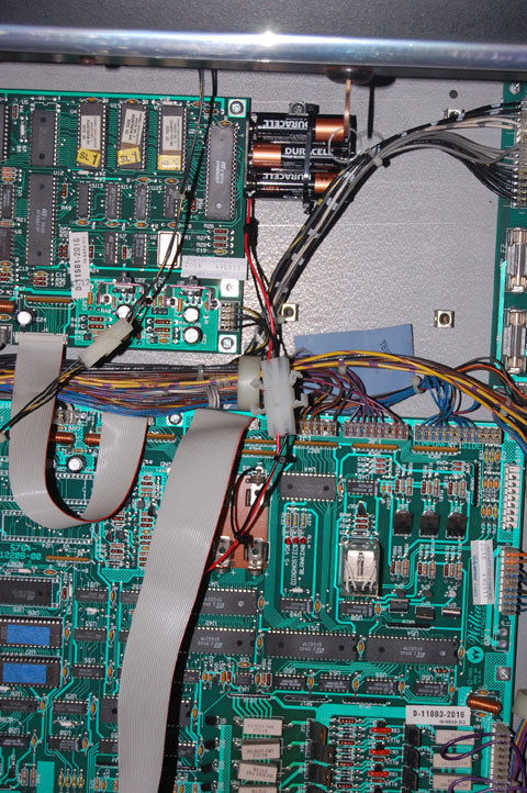

Sweet thanks guys. Replaced batteries but in closer inspection noticed a little acid build up on the middle battery's terminal. Wondering if it wouldn't be better to have a remote battery housing and solder the leads to the board the way my gottlieb is, any recommendations?
Yes, remove that battery holder and install a remote one. If you leave the acid damaged holder in there it will spread, and that would be bad.
Here's a pic of the battery mod in my Dr. Dude.
Not sure if it's exactly the same layout as Earthshaker, but they're both System 11 games.
It's recommended you change them about every 2 years from what I hear.
You may want to clean the battery terminals and make sure there is no major corrosion to the traces. Also take a look and see if anything dripped down on the components below. I think vinegar and or baking soda is recommended to neutralize the alkaline battery stuff, I'd do a search on that first though.
I removed the battery holder completely in my High Speed as it was pretty rotten itself (Duracell batteries best before 1994 !!!!) but the board was fine.....except for the switch matrix connector way below. Most odd.
I replaced them with a CR2032 and holder culled from a computer motherboard.
