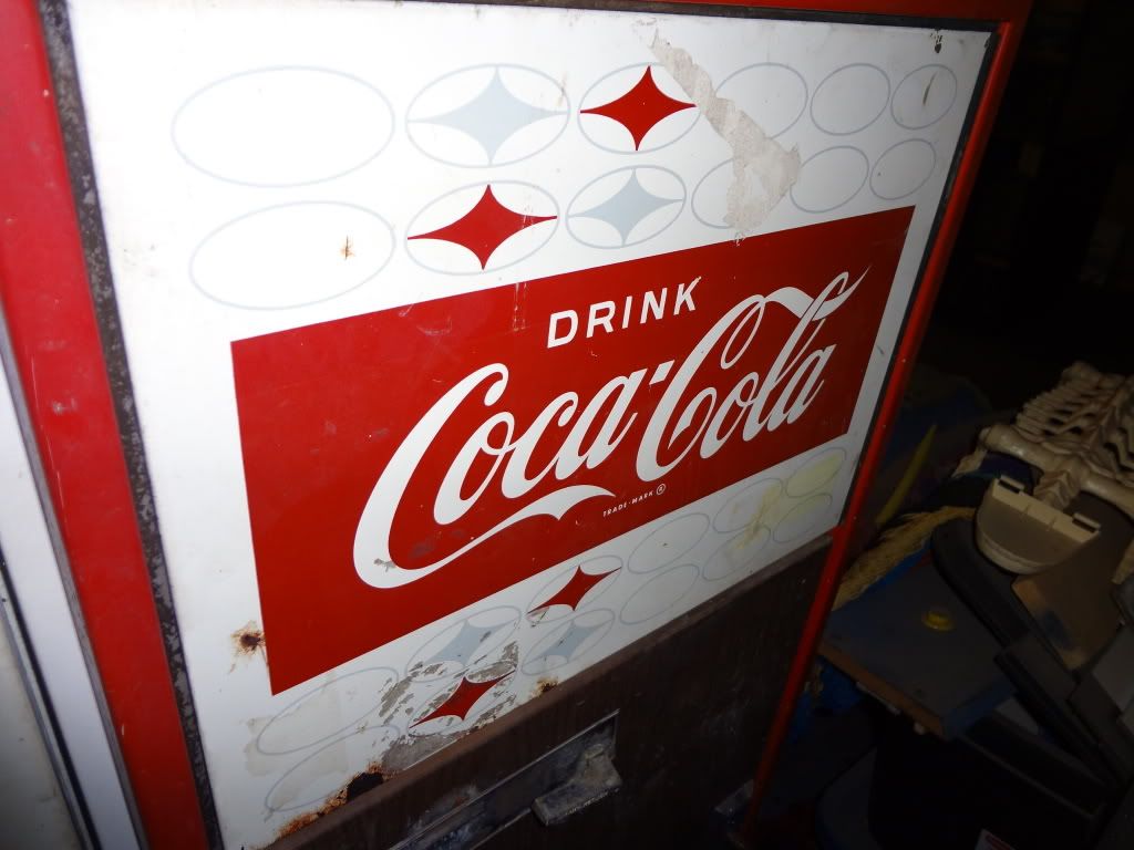

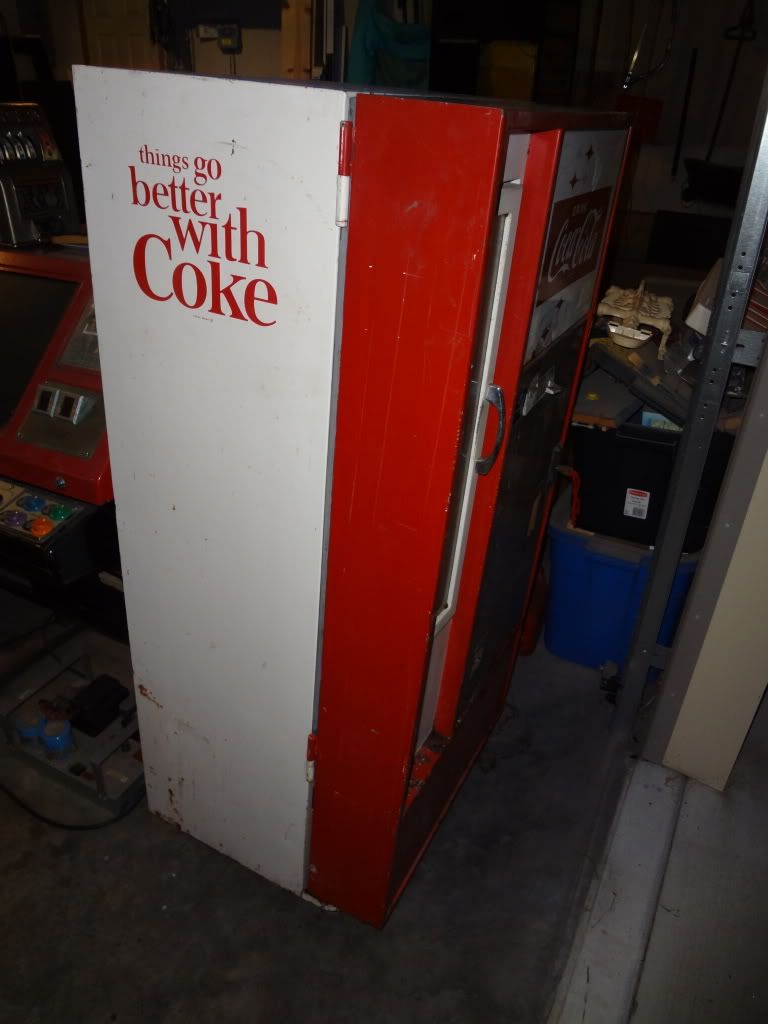

Solid shape, complete, hasn't been plugged in for 25 years. I hosed it off and now am doing some research on restoring it. Not even sure where to begin.
How interesting! I'm looking at getting basically that same model in a Dr. Pepper machine!
Thats a Vendo 56 bottle machine. Very good, dependable machine. There appears to be some rust under the sign and a few other spots on the front of the machine. The stylestar marquee is cool, but looks to be shot. I have some parts for that machine if you run into things you need. Is the inside complete?
Typically, when I get a new machine I spray it down with a good cleaner like Spray Nine or similar. That will break up any funk from exploded sodas and stuff. Pressure wash if possible. Let it dry for a day or so before plugging in. Give the wiring a good inspection and if nothing appears to be shorted or exposed, plug it in. The bottom fan should come on when the compressor is running. There is also a fan inside the cabinet that should be running. This fan stays on all the time. See if the machine is cooling before going any further.
Thanks for the info. I originally thought it was a 56, then did some research and kept finding pics labeled Vendo '63 that looked similar. I was right the first time. I used a high pressure garden hose on Sunday night to hose the outside and then the inside, bottle compartment, compressor, fan, ect. I'll try plugging it in tonight.

Keep in mind when you are restoring one of these square top machines.. resale value. a V56 isn't a high dollar machine, although the hope is these will be the round top machines of the future. If you are planning on keeping it forever, spend the money.. If you do get over to John's place, ask to see his collection. He has some pretty cool stuff.
Yeah he got back to me with a starting price of $3500 on a full resto. I do plan on keeping it forever, as it was my uncle's, but that's a little extreme for a machine like this. I'll take it apart, make stencils for the writing and decoration, have the local body shop paint the shell and then look for a new cooling unit.
That is a bit much to put into that machine.. The money will never come close to that for resale... Decals are available through a few suppliers, so don't knock yourself out with making templates. I have a few parts machines, so if you run into needing parts, let me know. I have a 56 that has been in pieces for a few years. I ripped into it, got most of the bodywork done and never completed it. The refrigeration systems in those machines are pretty solid. Before scrapping it, there are a few things to try to bring it back to life. I just resurrected one over the weekend that is from the 50's.
