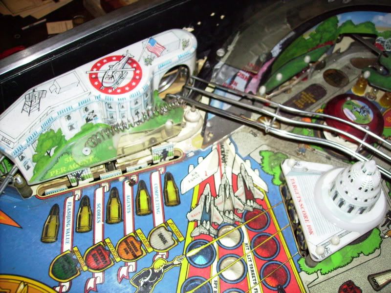

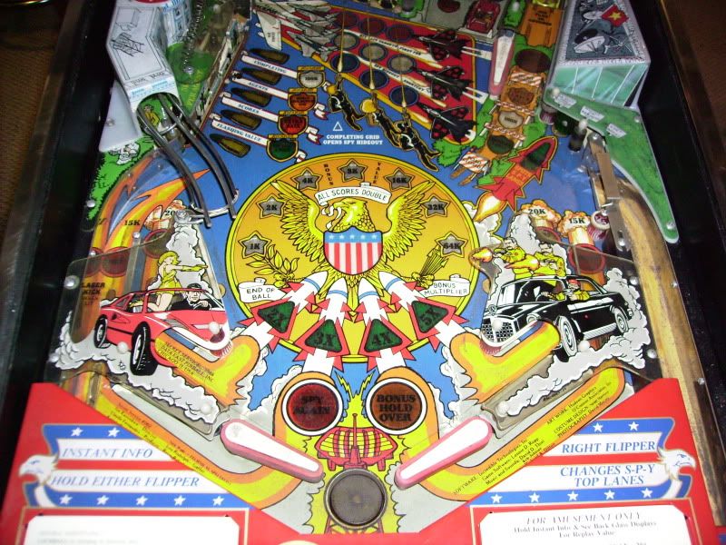

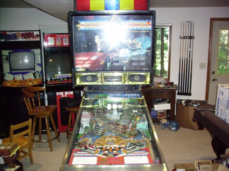

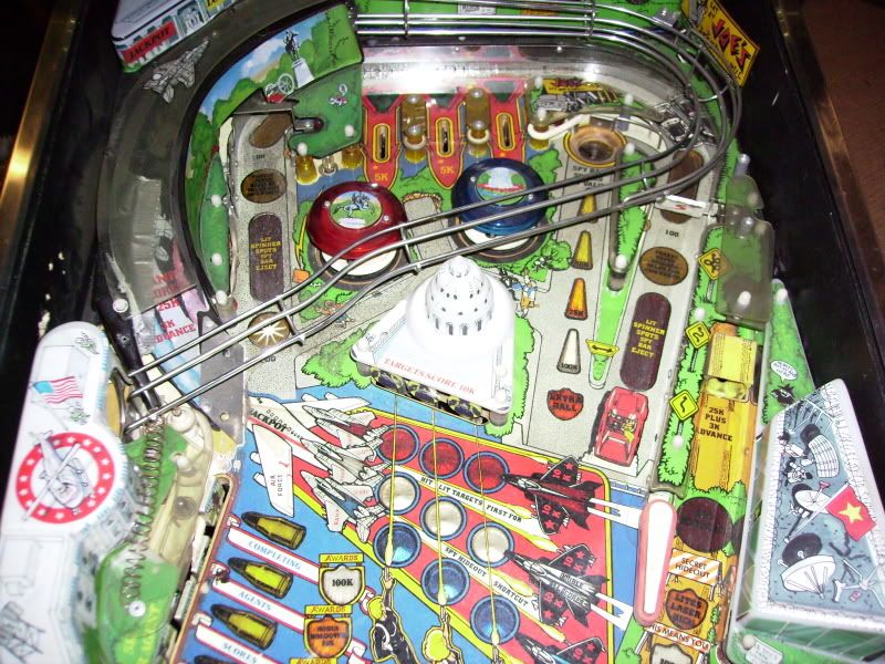

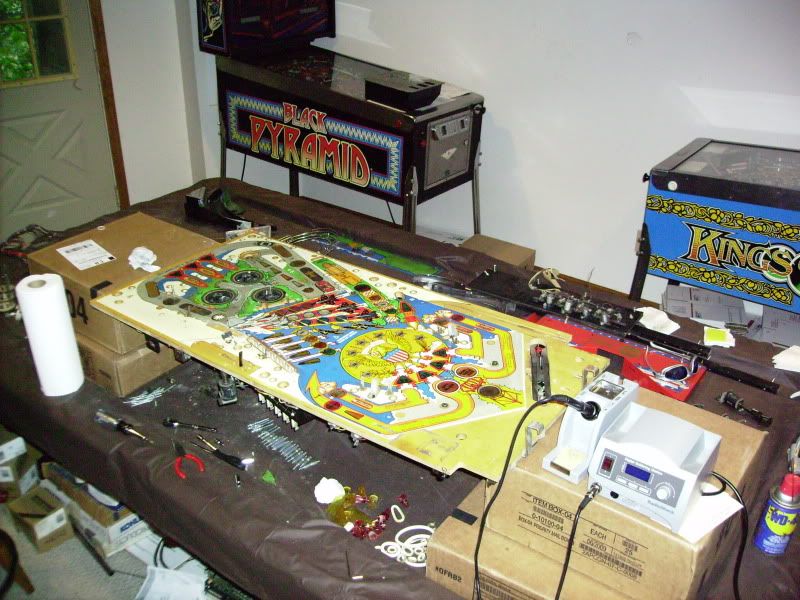

Picked up a DE secret service today. A friend of mine got it as payment for a side job, so I bought it off him for $200. I paid too much, but I felt bad for him, as the job he did was worth way more than that. It was on location in a family eatery gameroom before spending the last 10 years in the basement of the restaurant getting covered in a nice coat of grease and kitchen smell. It powered up and played (sort of) for about 10 minutes before dying completely. In that short time we figured out the bottom 2 displays are dead, all 3 pop bumpers are locked up solid, both slingshots are stuck and about 20 other things that need fixing at first glance. The only thing that seemed to work with no problems was the ball eater! The playfield is REALLY dirty, but should clean up nice, there are no spots worn through the paint so that's a good thing and I was able to run the test mode before it died and found all the lights on the topper worked. This is going to be my first attempt at shopping out a pin myself so it should be an interesting time! I already picked up a complete NOS set of plastics off ebay, but that's the easy part!

Well, got it back up and running last night. Bad ground and a blown fuse that I could have sworn I checked twice already. But, now for some reason every few minutes, all the G.I. lights click off for a second and come back on. That will be my next task, then I need to figure out if my 2 bottom displays are dead or just not getting power, and if so replace them. Then I can start on all the playfield fun. The guide on pinrepair.com has been REALLY helpful.
There is a relay in the GI circuit... they are SUPPOSED to click off and then back on every once in a while in attract...

I need the large black plastic ramp for the upper left side, mine is cracked real bad and duct-taped which makes it useless, the ball won't even make it up. I'm sure this is going to be a long shot and I will probably have to home make something.
The flippers seem almost too powerful on mine, they launch the ball like crazy.
I suggested to Frizzlefried awhile back, if a ramp is cracked and there are no parts available you can use epoxy. Make sure it's the kind for plastic not metal. Ensure you're mixture is 50/50. If there is a large chunk of plastic missing cut a piece from soda or beer can. Epoxy the hell out of it. Let it dry for ~24 hours. Sand to make smooth if necessary. Then spray paint with the cloth spray paint you find at automtive stores. The cloth spray paint has a chemical reaction with plastic that is tough as nails and won't flake off on you.
