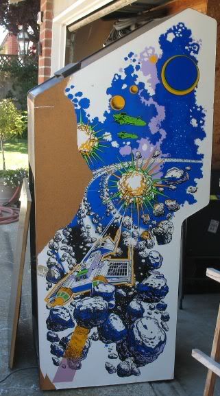

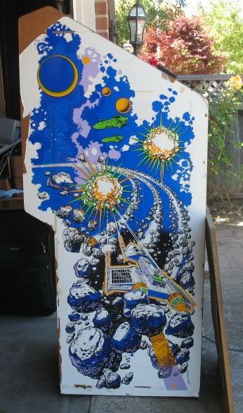

Its pretty decent except for the side art . Do they make repro side art ?

Mamemarques.com was reproducing sideart for Asteroids Deluxe. But I was just checking and I don't see it anymore. I remeber it was $189. I guess they got a ceast and descist from atari.
It's there man:
http://www.mamemarquees.com/asteriods-delux-side-p-447.html
It's just mis-spelt all to shit so it does not show up in a normal search...
I believe Rikitiki has mentioned something in the past about reproing ASD sideart if he could get his hand on the original gels or whatever he uses to do that...
It's there man:
AWESOME !!!! I didn't think there was repro sideart !!
