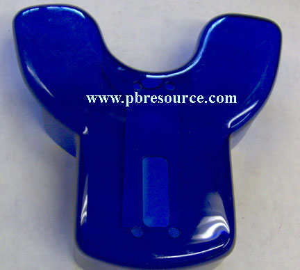

Picked up a Gottlied Cue Ball Wizard today for $425 today, game works but needs some tlc. I think I got a good deal seeing what they go for. It is missing a few things like the cue ball and 8 ball but I believe they are just regular pool balls and it is also missing the plastic piece on top that looks like the letter Y where the 8 ball sits, any idea where I can get that part. Also the legs are badly rusted and the chrome trim on the sides are rusted also, any suggestions on how to get rid of the rust. I am thinking of getting the legs sand blasted, good or bad idea. Also it is missing the backglass and trans lite but the guy I bought it from has already ordered a new trans lite so he is going to call me when he has it but I need a piece of glass, any idea the thickness I would need and dimensions.
I have been to his site, but he doesn't accept pay pal which I prefer to pay. Is there any other good sites for pinball parts? I have been to marcos specialties but he doesn't have the plastic Y parts on his website.

Ya, PBR has everything you need. Don't let the M.O./check thing scare you off; he does great business.
As for getting rid of rust, I use an awesome product called EvapoRust. Let the stuff soak overnight, give it a scrub with some fine steel wool then let it soak another night if necessary. I bought a 30" plastic wallpaper tray for soaking legs.

Just ordered the plastic Y shape piece, the decals for it and they small cue stick today from PB Resource.:) I plan to use some evaporust to get the rust off the chrome legs but what can I use to get the rust off the chrome trim on the side of the cabinets by the playfield glass since they won't come off?
