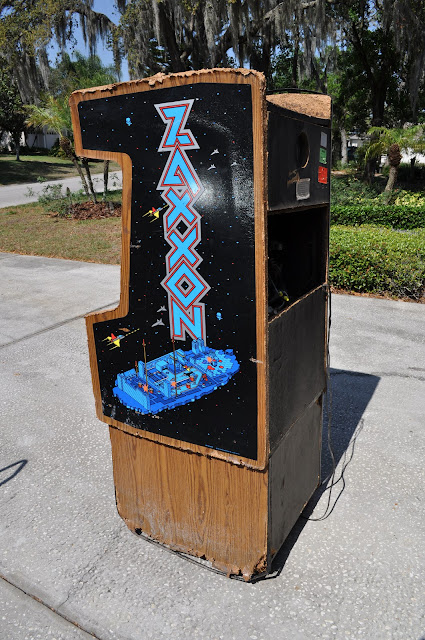

I'm going to be rebuilding a trashed out Zaxxon, but the base of the cab I have is too trashed to tell what it originally looked like. Please, if you have a nice Zaxxon cab, I need to get a pic of the sides of the base and a few close-ups of the coin door area. Did the coin door have a strip of t-molding along the top? Also, is the front door, that the coin mechs are mounted in, 3/4 inch or thicker?
