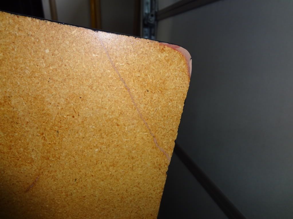

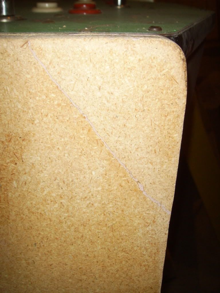

Thanks guys. Ok so here's what I'm thinking for the major repair for the right side panel near the kick plate... I've never done anything like this, so there may be a better method. Feel free to shoot holes in this.
I've got a piece of 1/2" birch ply that I'm going to use to fill the majority of the gap, that has a nice clean curve that follows the other side, which I used as a template. 1/2" is slightly smaller than the ply used to make the cabinet originally. This gives me some space on either side to fill with bondo, which should result in a fairly seamless repair.
Ok so here's how I'm thinking about doing it.
1. Wood glue in the replacement piece. Clamp it in place.
2. Drill two pilot holes and counter sink two small wood screws deep enough to clear the t molding groove in the replacement piece. Use very thin screws so as to not split the original plywood.
3. Fill in the screw holes with wood filler. Let glue and filler cure overnight.
4. Clamp a strip of plexi to the inside of the repair to use as a mold.
5. Quickly mix bondo and put inside an icing bag like this:
6. Squeeze bondo into small gap between replacement piece and plexi using said icing bag.
7. Glob bondo on to outside gap. No need for a mold here because it can be easily sanded.
8. Let bondo cure over night.
9. Remove mold and sand.
10. Use dremel tool to meticulously cut a new t-molding slot in the replacement piece.
Ok... so does this method have any shot at working? Haha

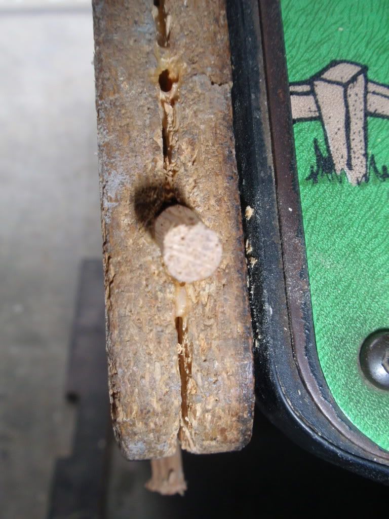

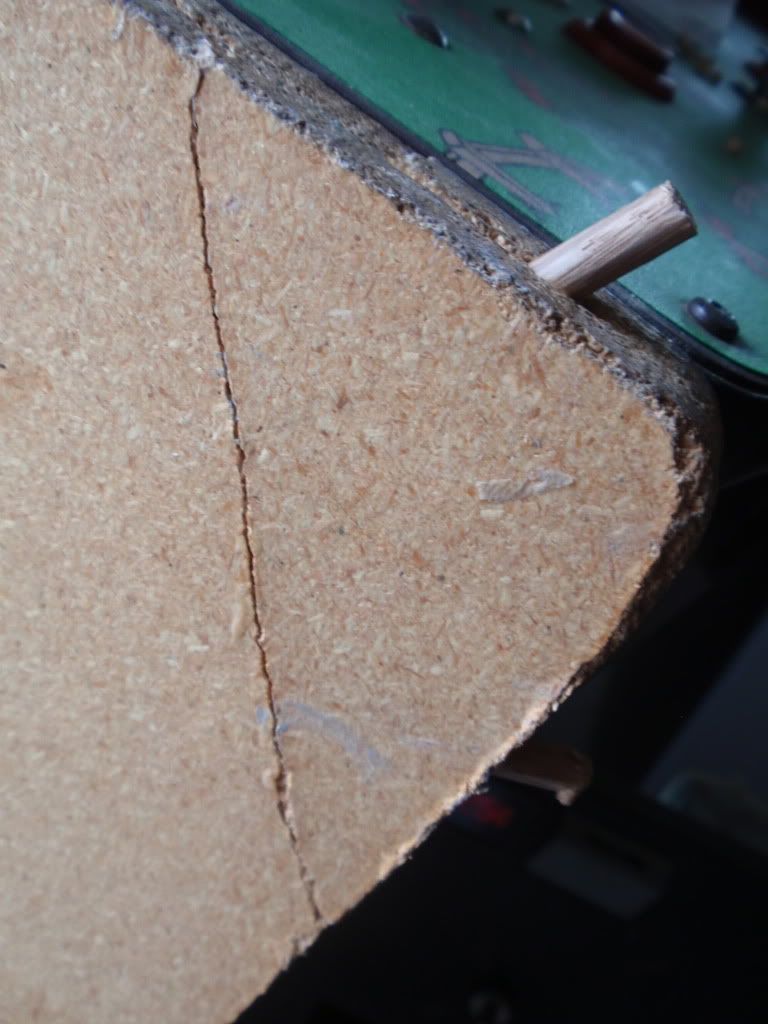

Do everything you said but instead of screws, drill 1/4" holes edge-on through the repair piece into the cabinet, keeping the bit perpendicular to the cab sides and use 1/4" dowels. After the glue sets, cut off the dowel stubs, bondo, sand and cut the new t-molding groove.
Ok, so here we go! It needs a bit of sanding and lots of bondo, but the difficult part is over! I don't have a drill press; it was pretty scary drilling 1/4" holes end-wise into half inch ply freehand! But it's in there, it's straight and I don't think it's going anywhere. The dowels with glue on them were really snug... nice and solid, even before being clamped.
Thanks Phetishboy for the tip! :D
