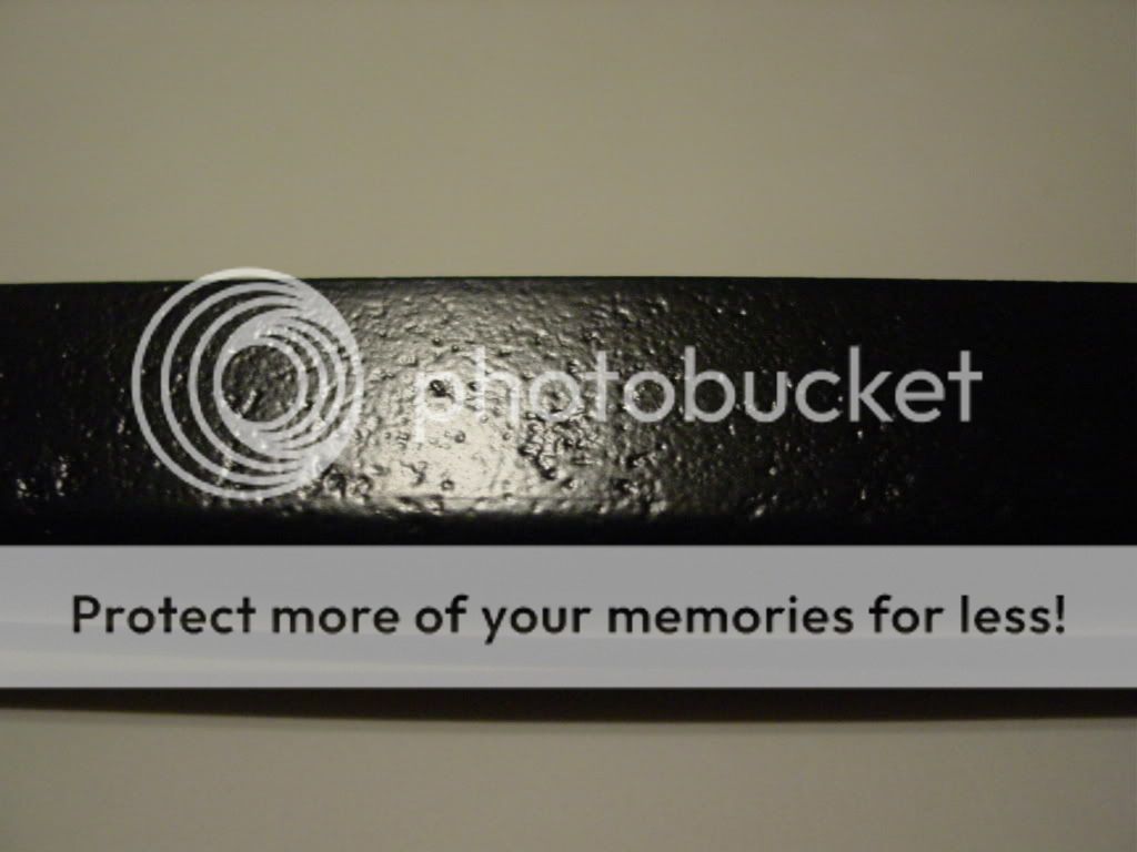

I wanted to show everyone a few examples of what the metal will look like after powdercoating with prior damage. Let's take this piece to start with. This person told me the surface rust was no big deal on this cp and marquee trim for Pac-Man and to sandblast and coat the part nothing more.
The sandblasting removed all the rust, however the powdercoat bonded to the pits left by the rust.

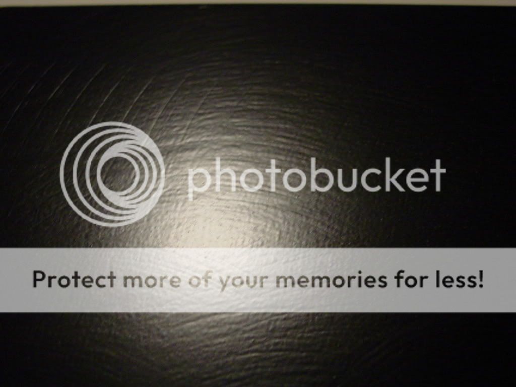

Example number 2, a person sends me this Galaxian CP and tells me he is a world class painter and has attempted to repaint the panel himself.
It looks like a die grinder was used to remove the overlay and I am stuck with 40 grit grinder marks. Even after the sanding blasting. Once again the powdercoat has bonded into the damage.

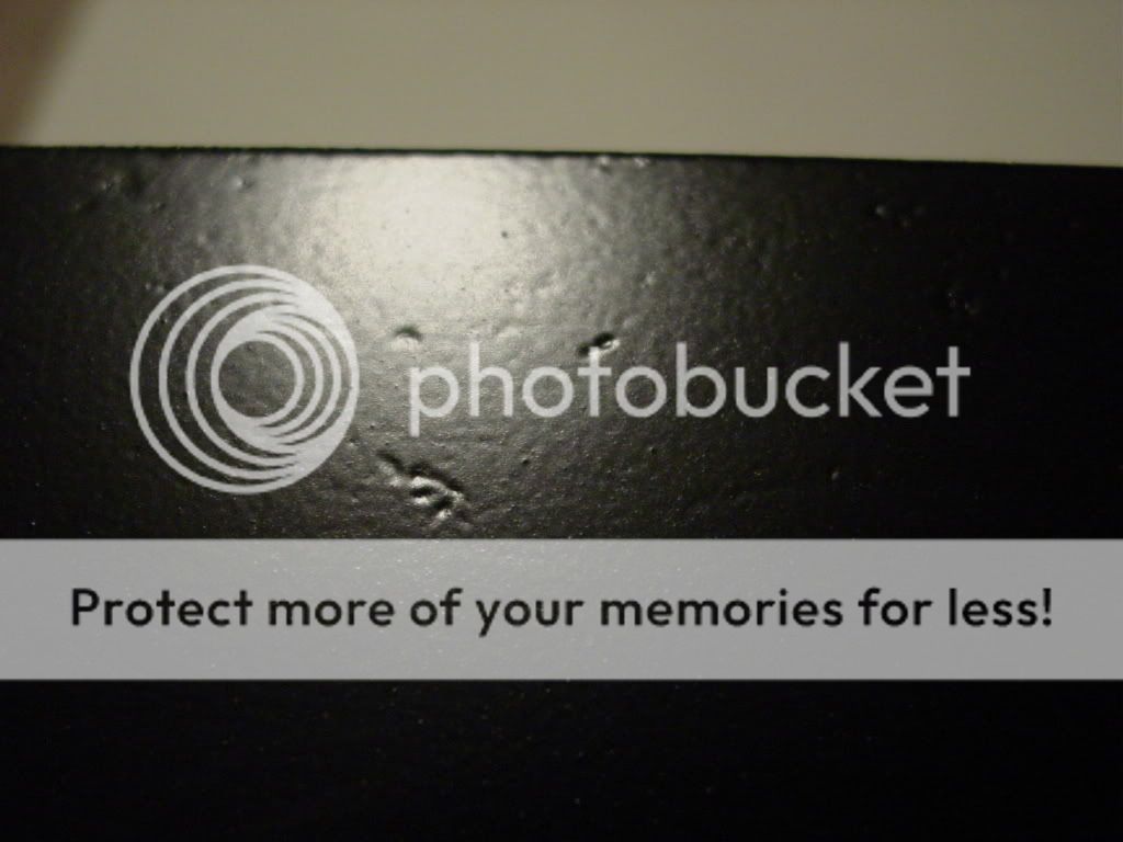

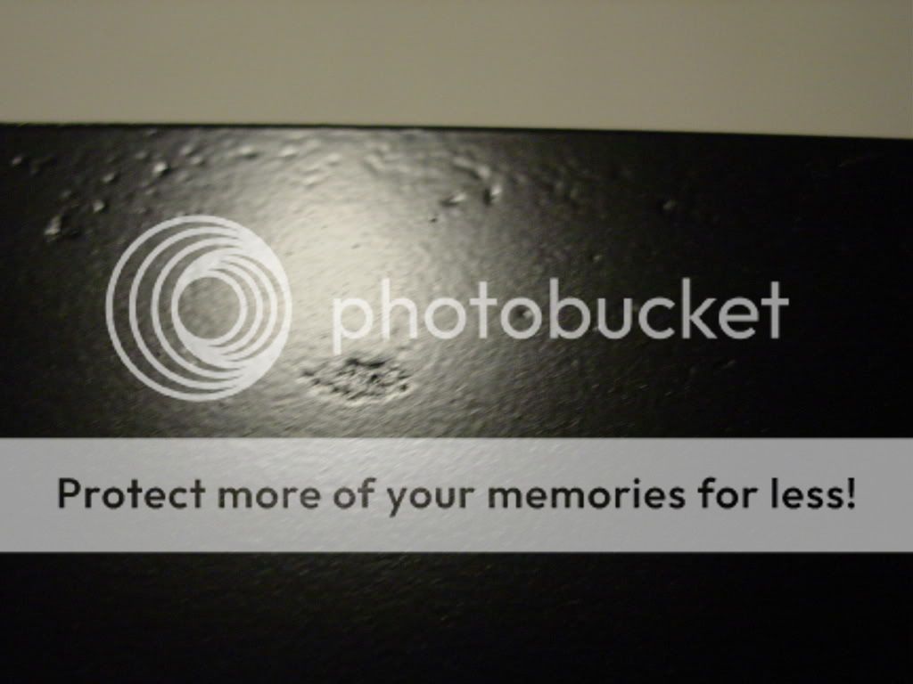

Example Number 3, Dents and other damage. If you want semigloss black colors, please be sure to send parts with no damage.
