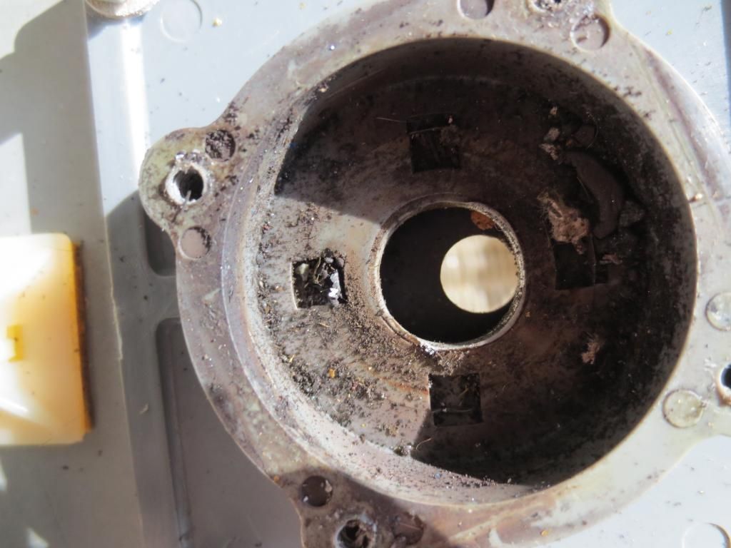

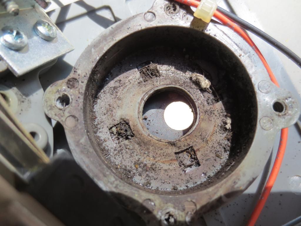

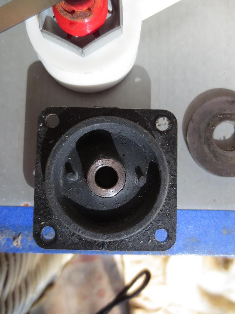

The joystick on my Pengo is sloppy as hell . I picked up a new grommet from klov member generic and it did improve , but still sucks .
Are there other parts I can replace to try and rebuild this joystick , or should I just buy a new one from Bob Roberts ?
I've never messed with rebuilding a joystick .

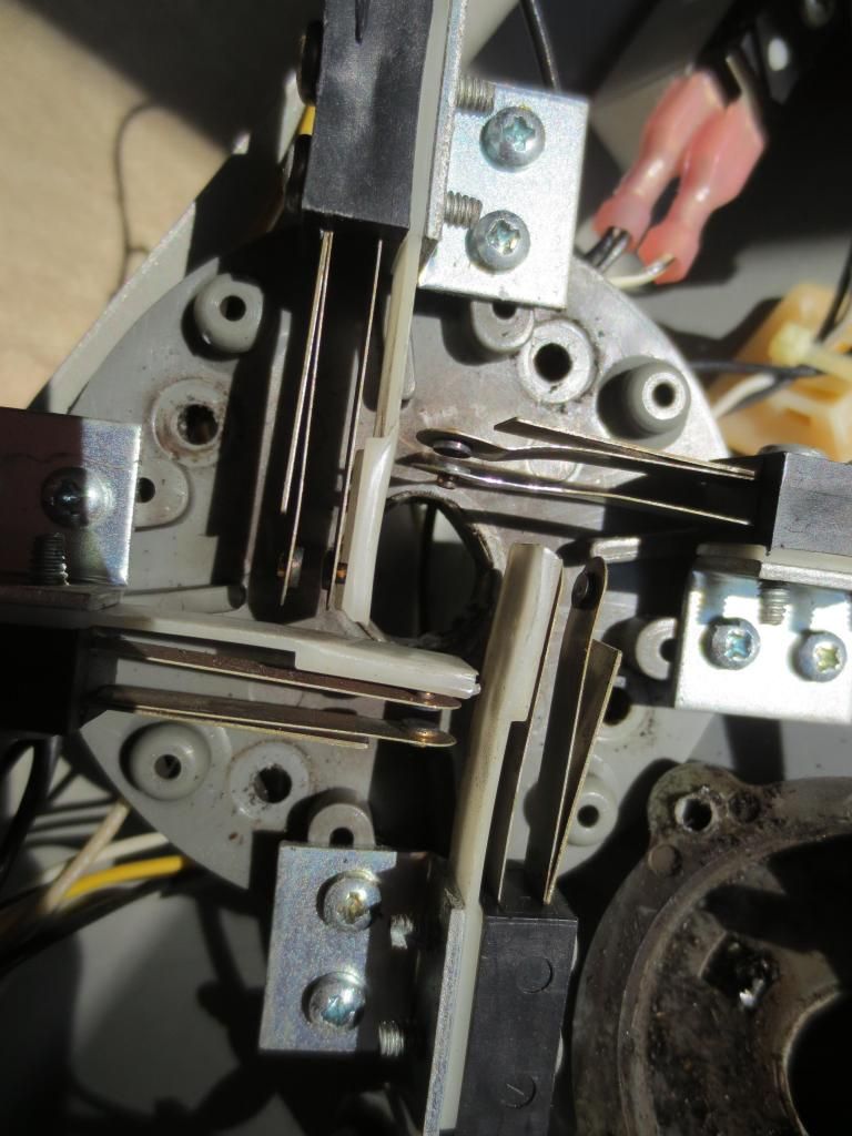

Ensure the switches' prongs are all straight like the one I sent you.

All depends what kind of joystick you've got.. The couple pengos I've played, one being HUO all used a 4" red ball wico joystick.

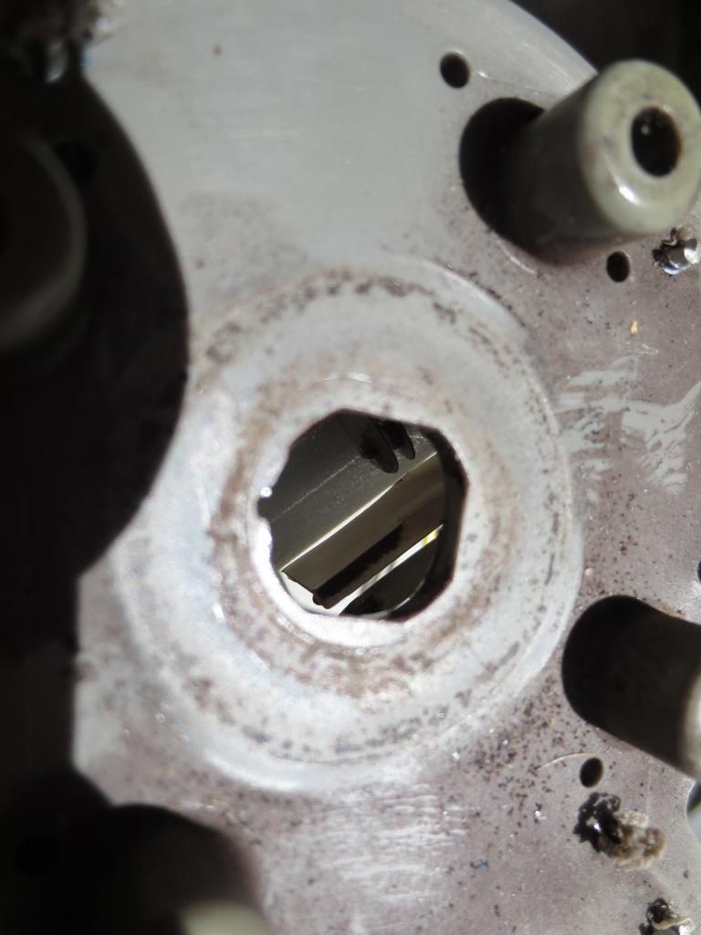

If its still sloppy after a new grommet.. Your gonna need a few parts:
New actuator
New leaves if beat up
New top and or bottom halves of joystick base
Possibly a new stick if yours is worn badly on the shaft
Post a pic.
Buy new, sounds like too much is wrong with what you have. The original stick is a slim red balltop leaf. If this is what you have and you can't find a new one to buy, then I'd reconsider and try to restore the one you have unless the actual base where the shaft connects is all egged from wear and abuse. These sticks have a smaller red ball on the top than the main ones sold. I believe an original Dig Dug would also have this smaller top controller.

I just pulled my Pengo manual and looked up the joystick.
Page 31. Item Number 17. Joystick 4-way Long Shaft
Which refers to a 4" red ball shaft found in robotrons or it could also be the long skinny shaft found in frogger and other Sega games. But like I said before, my buddy has a documented HUO (cereal contest winner) Pengo, its got a 4" red ball wico.. Another buddy has a routed one, but its original.. Also has a 4" stick..
So there ya go.. Rebuild what you have or buy a shaft from Wolfee and rebuild your base.. As fresh Wico's are a hell of a lot better than a Asian knockoff or micro switch joy..

Wow every part on that joystick is worn to hell except the grommet. The shaft appears to be the thinner long shaft with the small red ball common on early Sega games or are the pictures misleading?
I've got the parts to make u an almost new joy.. Shoot me a pm if your interested.
Thanks for the parts , installed them the other day .
Holy Crap !! What a difference , its like having a rusty $100 car from the junk yard to a Brand New Expensive Porsche !
Super Smooth , accurate gamplay .
I'm not putting up with a worn out joystick again .
