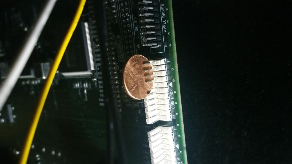

Trying to find a source for connectors and crimp receptacles for atari/midway Cruisn series boards.
Does anyone know what type of connector and crimps to get for this? what size is it?
Thanks!
Here's the pins I was talking about on the Exotica board:
Would these connectors fit?
https://www.mikesarcade.com/cgi-bin/store.pl?sku=SCH-05
https://www.mikesarcade.com/cgi-bin/store.pl?sku=FCH1
Those are Pancon brand 0.1" headers. Can use with Molex 0.1" KK series plugs or AMPs 0.1" equivalent connectors as well.
Which ever brand you buy - don't forget to buy the keys!
And don't buy the cheapie Chinese equivalents - they're made of some horrible pot-metal that goes bad in no time. The link to arcadepartsandrepair shows Molex contacts --> good brand.
