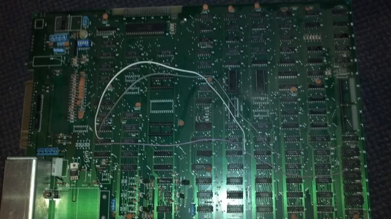

PCB Board Identifying
Well, I just got a Moon Cresta in a 3 board stack...so I am confused...are there different kinds of Moon Cresta PCBS with different pinouts?
Moon Cresta runs on Galaxian hardware. You'll find MC on a variety of bootleg Galaxian-style boards. The Nichibutsu made board doesn't even have an edge connector... it uses headers.
So how do I hook up a non bootleg Moon Cresta to a cocktail that was changed over to a harness for the bootleg one? I am thoroughly confused.
