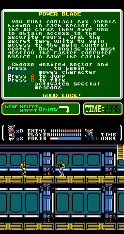

Cool stuff! I love my Chip and Dale. But, what is Power Blade??! Don't know that one. Looks cool.
pulled it up in mame (ps just finished getting full 196 gb set with all chd's took like 3 weeks to dl )
its a type 7 cart
here are the specs
Power Blade 7T PCH1 4 G 27C010 LH5116D-10 2764A (ID) 27C010-2 NO 20 29 27 3 17 7 1 16 12 38 X U9 is 74LS367AN and U10 is 74ALS139N U8 is a Surface mount custom
you can dl that pac i made above it will tell more info in the pdf file
