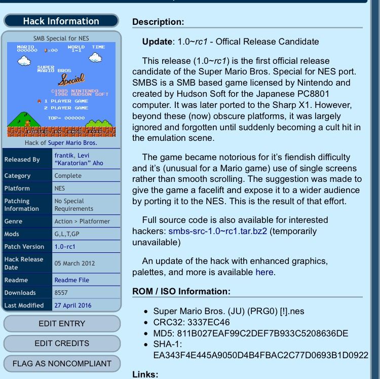

Tell us about your Super Mario Bros. Special. I don't see it on your site.
It was a customer request as almost all of the games are. It will work on Baseball Stars directly, or Fester's Quest, TMNT, Rescue Rangers, Tecmo Bowl if some Ram is soldered into a spot. Here is the information on the game:
