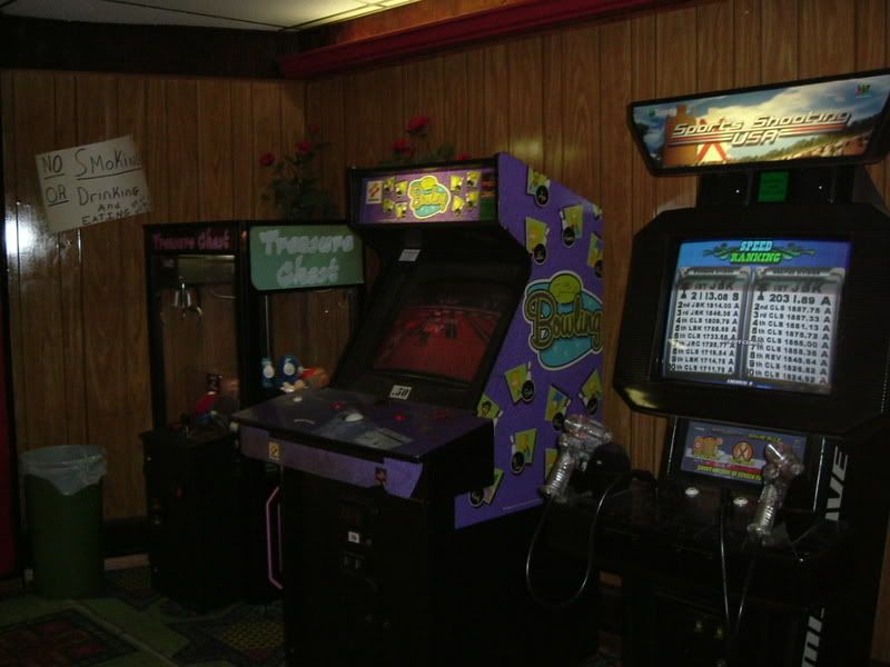

I believe this is a greyhound / united textiles crane machine. It looks like i am missing the whole claw assembly. All i have are the molex connectors that would plug into the assembly if i had it.
Does anyone have the claw assembly or know where i can purchase parts?
It looks like the one in the corner of this picture (not mine):
http://i11.photobucket.com/albums/a...ry Lanes/TreasureChestCraneSimpsonBowling.jpg
