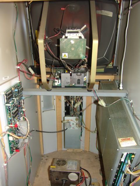

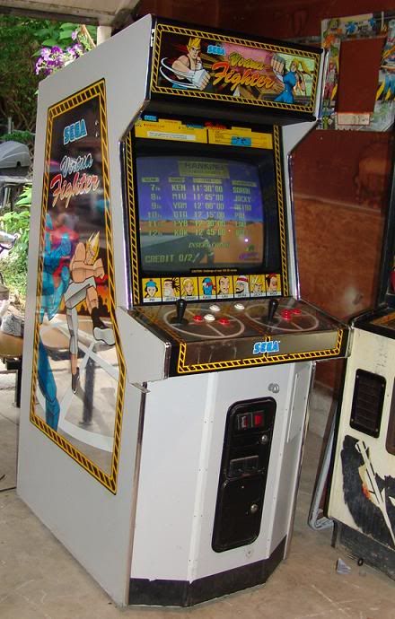

Everything on it works except for the monitor having issues with staying on.
Pm if interested in any part.
why gut it man fix it up!
btw the monior is the big money in that machine.. working dual res monitor like that goes for $175-250 depending on screen burn and picture quality. Supposedly some of the sound boards work in other sega games too..
yea there's no screen burn and picture is perfect, just wont stay on sometimes. I've been trying to fix it but have no idea what to do.
I worked on one of them before... IIRC it had some bad solder joints, and they're notorious for having a bad C433 (10uf 50v) and R433 (2.2k ohm), and sometimes R436 (15k ohm).
