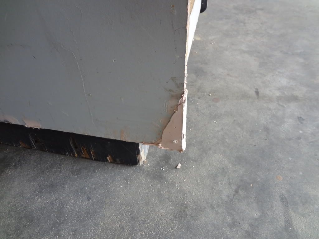

This one is on a dedicated Nintendo Vs. cabinet.
Corner was busted right off. I screwed 2 screws into the cab side edge-on and tried to sink them in deep enough to be below the slot cutter blade, but far enough out to add structural strength. After that I crafted a mold from scrap plexi and foil tape. I used the other corner, which was still intact, to create my curve in the outside mold piece. That acted as a guide when it was time to sand down the 90 degree corner. Always a good idea to make the bondo thicker than you need, then sand it down to size and shape. Thought I had a before pic, but I can't find it. Oh well, just imagine that the first pic (not pictured) is the corner busted off and all that remains is jagged particle board.
Looks great! Can't even tell. Its amazing what looks like a simple repair is so time consuming. People who've never done this or automotive body work have no idea why repairs cost so much money.

Looks very good Phet, the bottom base is coming appart like some of the Nintendo cabs i have. Do you just putty those up and sand it down? Or do you replace the entire base?
Another great looking repair! Such a beat up cab. From the primed picture you would have no idea of the work that went into it. It just looks so perfect!
