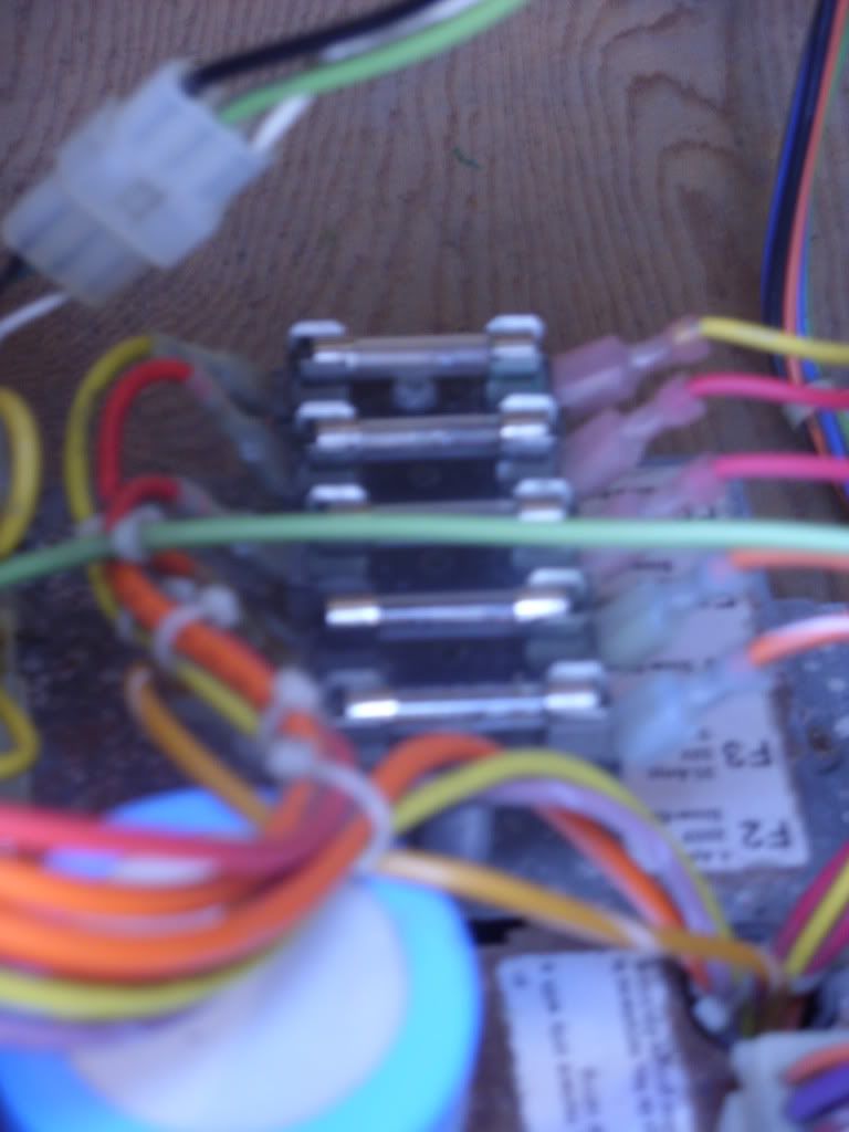

All the fuses check fine. One fuse and wiring is completely missing from the fuse block, but I just assumed it wasn't necessary for paperboy. It is present on the Champ Sprint Power block I have as a spare.
Let me go look at my block. Dont think im missing a fuse. I know my asteroids deluxe block is like that.
Here are some pics of mine. I have 6 fuses total, including the one in the black fuse holder. Also I need to read back thru this thread. Have you tested the +5 tab on the main pcb, and the +5 tab on the video pbc?
I haven't tested any of the 'tabs'. The only tabs I saw on the ARIII were +SENSE and -SENSE. I guess I didn't look close enough. +5 on the CPU is fine, because it is supplied by the switching power supply. I tested for +5 on the video pcb directly on the input connector coming from the ARIII. Didn't test for -5, because there is no -5 supplied by J13 to the video PCB.
IIRC, mine is missing F3. The fuse and the wiring is gone. Does that have something to do with the switcher being used to power the CPU board?
