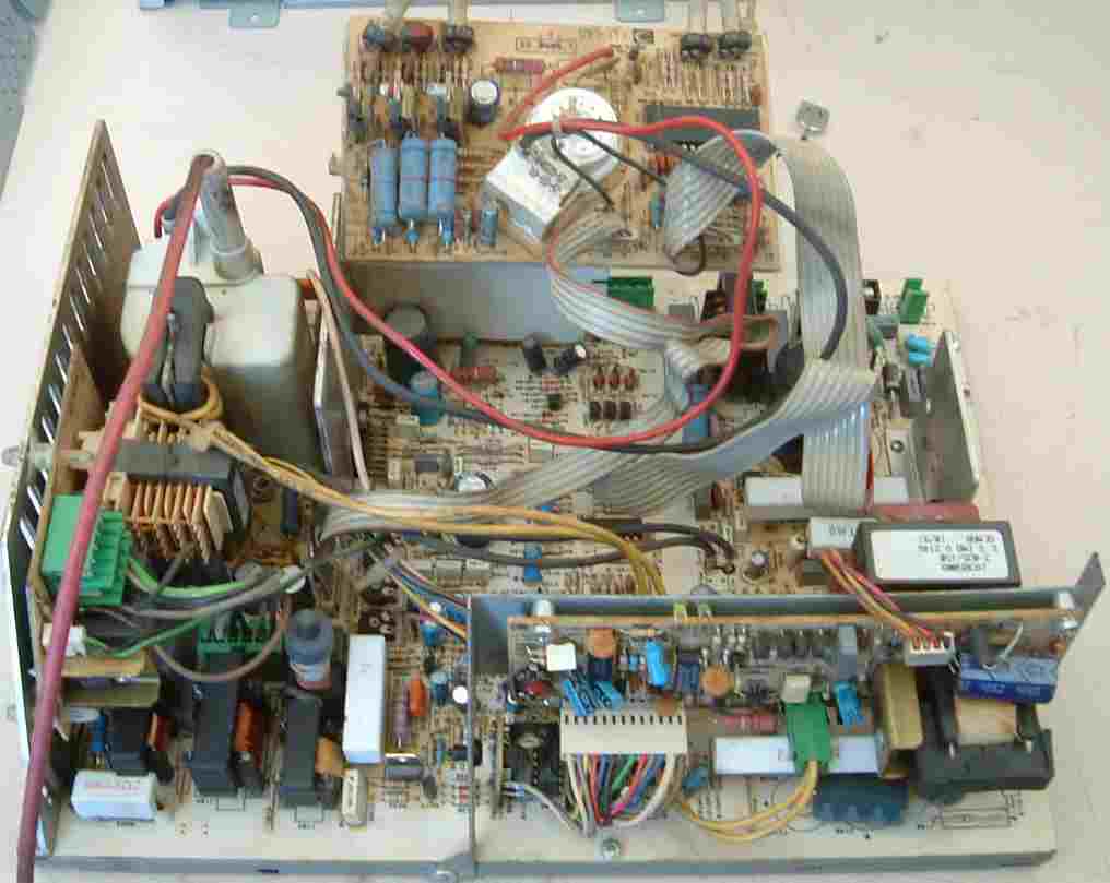

hi guys!
i need to do a capkit on my paperboy med-res monitor, but i have NO IDEA which kit to get, because i can't figure out which monitor / chassis is installed in the cab.
here's a pic of the chassis:
this is what's written on the side of the chassis:
and finally two pics of stickers on the neckboard and the tube:
does anyone have an idea? i could take more pics of that would help!
thx a lot, guys!
Well, the MS/245 may be significant, but all I can find is that it is an Intervideo dual-res chassis. You'll probably have to build your own kit. No model number listed on the ID site:

As for building your own kit:
If you have bulk caps on hand, then you can just pull them one at a time and replace them with new. If you have to order caps, then go over the entire chassis and check all of the caps (paying attention to whether they are polarized or not) and write down their values and locations. Then make up your order....

since i've just recently done my first cap kit (successful i must say), i don't have bulk caps on hand, so i guess i'll have to do it the hard way!
btw, the reason why i want to do a cap kit on the monitor is that the picture is shifted to the left and can't be brought into the correct position by either one of the knobs i have for adjusting the picture. i hope that a cap kit will help me solve that problem ...
