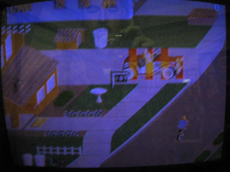

I just picked up a Paperboy project and there are a couple issues.
First off, the monitor is very dim. I suppose a cap kit is in order. It currently has a K4900 medium res model in it. Is there a specialized cap kit for it vs the low res model? Also, I DO have a K7000 medium res chassis on hand... I suppose the tubes aren't interchangeable between the two by chance?

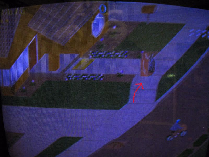

Secondly... I am getting some corrupt sprites. Mostly sprites that "move" or do things (break dancer, all cars that travel across the screen (though the vertically running cars are fine), the fighting guys, etc). It even happens to the same sprites in the "paper" intro screen, etc! Any idea where to look?
Here are some pix... (enhanced to increase brightness to help)
Looks like both of my sys2 cabs with the black sides. Ha ha.

And the sprites... Have you run through the diagnostics to let it do a rom test? Maybe a bad rom? I had a bad rom that was causing bad sound effects.

You have game ROM issues causing your sprite issues.

...I swapped all 4 6116's and unfortunately the problem remains the same. I suppose that eliminates the 6116's... now, which chips are the ROM chips? I suppose I should try to pull and re-seat them before anything but there are a TON of socketed chips...
I DID try to press down on them all of course... no help.

i woudn't say that swapping the 6116's definitely proves they aren't they problem. I had multiple 6116's bad. And your issue could be socket related, too.
As for your ROMs, did you pull them and clean them?
If I recall correctly, the ROM test that you describe is corect, no test if no issues.

Both PSes are putting out proper voltage... 5.08 or so... reseated all connectors... pulled and re-seated all socketed chips... the issue remains... no change at all.
I have not cleaned the ROMS ...being there are 26 of them, that will take a bit of time... I'd hoped that pulling and re-inserting them would do SOMETHING ... alas... no difference.
I can play the game fine BTW...just those sprites are jacked...
Just dealt with a sprite issue on a Paperboy that was almost identical. Narrowed it down to a ROM issue. Wasn't able to nail it down to a ROM, Socket, or Bad trace because the boardset quit working.
Welp... being I have no way to check the ROM's... what options am I left with?
