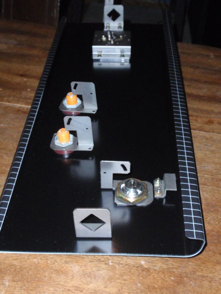

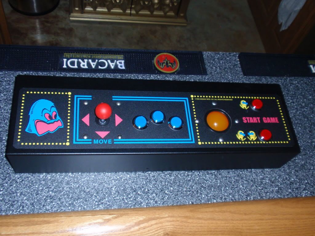

I have converted to powdercoating all my metal CP's. They media blast the whole thing first, so no overlay stripping needed, which is a huge plus for me. The results are fantastic, the underside is clean and fresh, and the new overlays stick the first time, every time. Also, if you need to reposition, you don't have to worry about pulling up poorly adhered spray paint. Can't go wrong.
I just repainted my CP for my Xevious with Rust-Oleum semi gloss and had great results. I sanded it to metal, primed, and then painted. I let it set a week or so for the paint to really harden.
Turned out really well. I have access to a powder coater through work, but I haven't used them only because I'm afraid they'll lose my stuff. I mean, anything can happen to one part and I only have one each.
I powder coat all my metal parts. Mainly for the durability (wont scratch) and longevity. Also the CPO seems to stick very well. Just my 2 cents.
