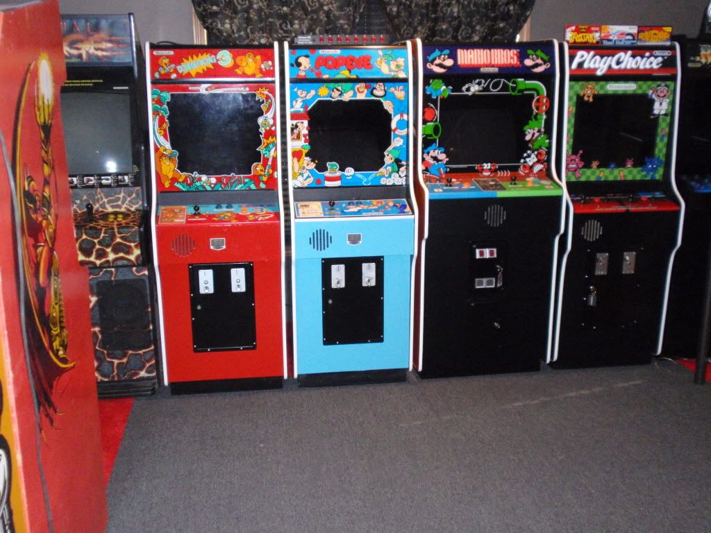

I painted up a few of them a few months back and they are more of a matte gray metallic. Not quite as dark as a pewter, not quite bright enough to be silver, and certainly not metallic enough to be chrome. I'll check what I used and post a close up when I get home if I remember. This is the best I can do for now:
The DK3 has the painted face plates, the Popeye has unmolested face plates and the playchoice actually has originals that are shinier than any other Asahi Seiko face plates I've yet seen.

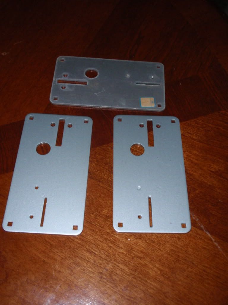

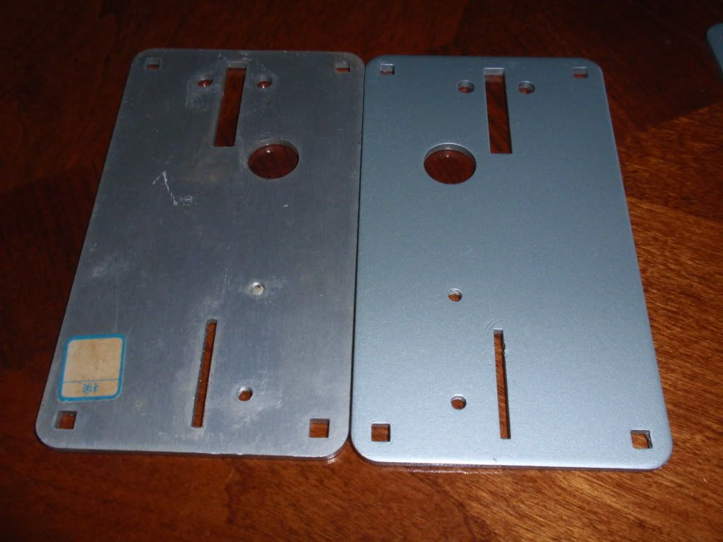

Yeah it was matte silver I used. I usually just polish them and leave them alone, but I thought I'd give painting them a try. The matte silver is not a perfect match to the original finish, but close enough for me. I also sprayed the mechs with an oil-based clear coat. The original finish is on the left:

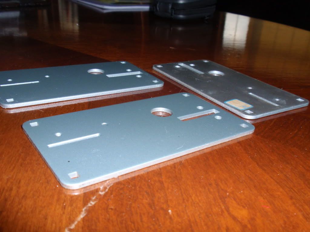

More comparison pics:

No problem. I also have stainless steel appliance epoxy here that I was gonna try, but that seems to leave a weird residue like little metal shavings on the surface you paint. Me no like. Matte Silver or Satin silver (2 coats) with a clear coat (3 coats) should protect the surface enough to not get scratched by quarters again.

Satin silver and Rustoleum satin clear. I think they turned out nice.
