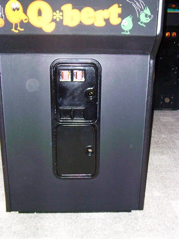

i was going to ask you phet what type of black to use for cabs. I'm doing a qbert this weekend or next. i was going to go with a oil based satin black, and if they don't have that use semi gloss? i seen on your qbert you ended up putting vinyl on the front was there any paint specific reason you did this?
i was going to ask you phet what type of black to use for cabs. I'm doing a qbert this weekend or next. i was going to go with a oil based satin black, and if they doing have that use semi gloss? i seen on your qbert you ended up putting vinyl on the front was there any paint specific reason you did this?
No, not really a paint issue, more like a surface/finish issue. No matter how many times I bondoed/sanded/bondoed/sanded, etc, I could not get a finish smooth enough to my liking. Then when I put the adhesive backed lower marquee on the cab, the mis-matched finishes bothered me even more. I happened to have a roll of the Happ textured vinyl here and low and behold, the finish was a near perfect match to the finish on the lower marquee. I butted the top edge of the vinyl up against the bottom edge of the lower marquee, and now it looks like one continuous piece of vinyl, save for the seam you can't see unless you bend over and look for it (how many times has Fritz used that phrase?).

i see what you mean, from the pictures it does look like one continuous piece. i have vinyl left over from my system 1 cab from rich but the texture prolly wont match, i'll have to look around at happ and see if i can find some. i just found a complete qbert wire harness with the interlock and original service panel, so my black jammatized qbert project can move forward.
