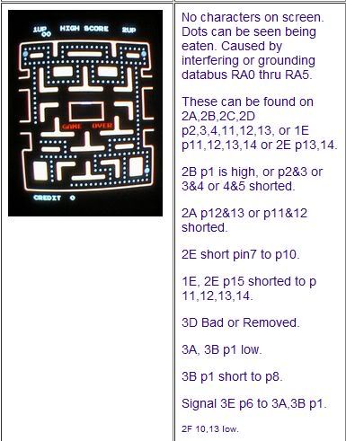

Hey guys, I have a pacman board it comes up and works but there's no characters on the screen, you can play it and watch the dots disappear but no ghosts and no pacman
I know all the roms are good, I've switched out all the socketed ram with known good ones still no go, any ideas?
Thanks!

A logic probe would help a lot here. Especially one with audio so you can hear the slight differences between those signals.
I had the same thing happen on a board I had, it ended up being on the VRAM Addresser daughter board.
Lawnmower man's site said this.......
"Plays, No Characters in Maze or intro Screen. Dots visible & disappear as eaten.
(rare case) Dead 74LS157 at U5 of V-Ram Addresser (rare case)."
I replaced one of the 3 74LS157's, it fixed my problem then started doing the same thing again after a few hours. I replaced all 3, and haven't a problem in over a year!
I'll look at my board tomorrow and confirm that those were in fact the chips I replaced
