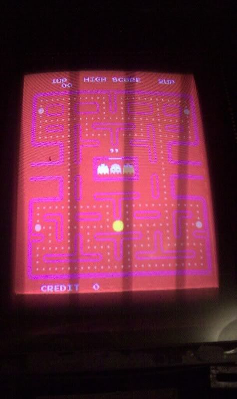

Great...new problem: I plugged in a galaga 3 board just to test it for a diff problem with galaga, plugged pac man back in EXACTLY like I unplugged it...and now my whole screen is showing a red tint over everything......I dont understand what would be causing this....any help would be GREATLY appreciated!

Thats just it tho.....The red ghost in the game is not there...just his eyes, the red pots do nothing for adjustments, the game comes on just fine, plays fine, but there is an overwhelming red tint on top of everything, yet its not in the game (ghost, fruit, etc) like it needs to be......
If the red pots are turned up too high they can overpower the balance like you are seeing. Couple this with no red coming off of the board and you will see what you are seeing, no red ghost and red missing causing the colors to be off.

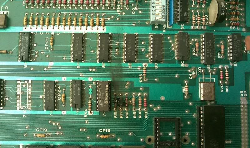

Looks like I've found the problem, all that switching must have burnt out these resistors. Looks like a radio shack trip is in my future. These things hard to solder? I have past experience soldering guitar electronics, but this is a wee bit different, but Im willing to try...
my next problem is, Im not sure which resistors I need to buy, seeing as how the two are burned pretty badly and I cant tell how many bands and which colors......While I am enjoying getting this pacman up and running, it is becoming quite the challenge! I am curious how moving the edge connector would have caused these resistors to burn out. Anyone have that happen before? Thanks for all your help so far!
