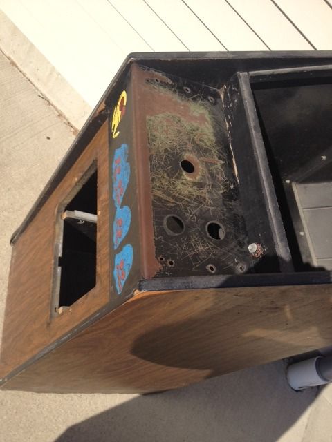

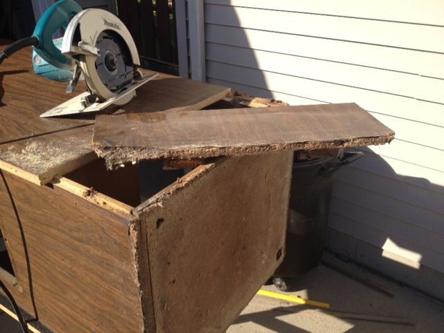

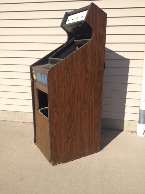

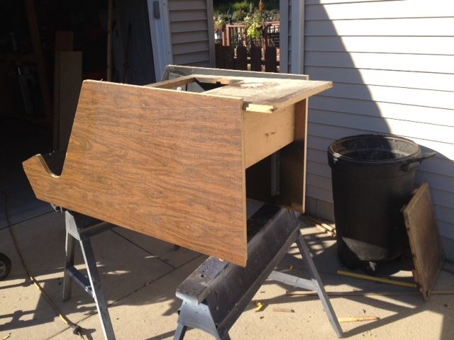

I've been wanting an Arkanoid (and a couple other games) for a while and am almost out of space in my arcade. The solution - Cabarets. I can fit 3 cabarets in the space that 2 full size uprights take. I picked up this trashed and gutted Pacman cabaret up earlier this year. It has water damage that go's 8" up one side on the bottom. The floor is shot. I figure it's a perfect candidate for the project. Today, I chopped the water damage off of the bottom:
It rained until early afternoon, so I got a late start. I chopped the water damage off of the bottom:
More progress to follow tomorrow!

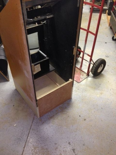

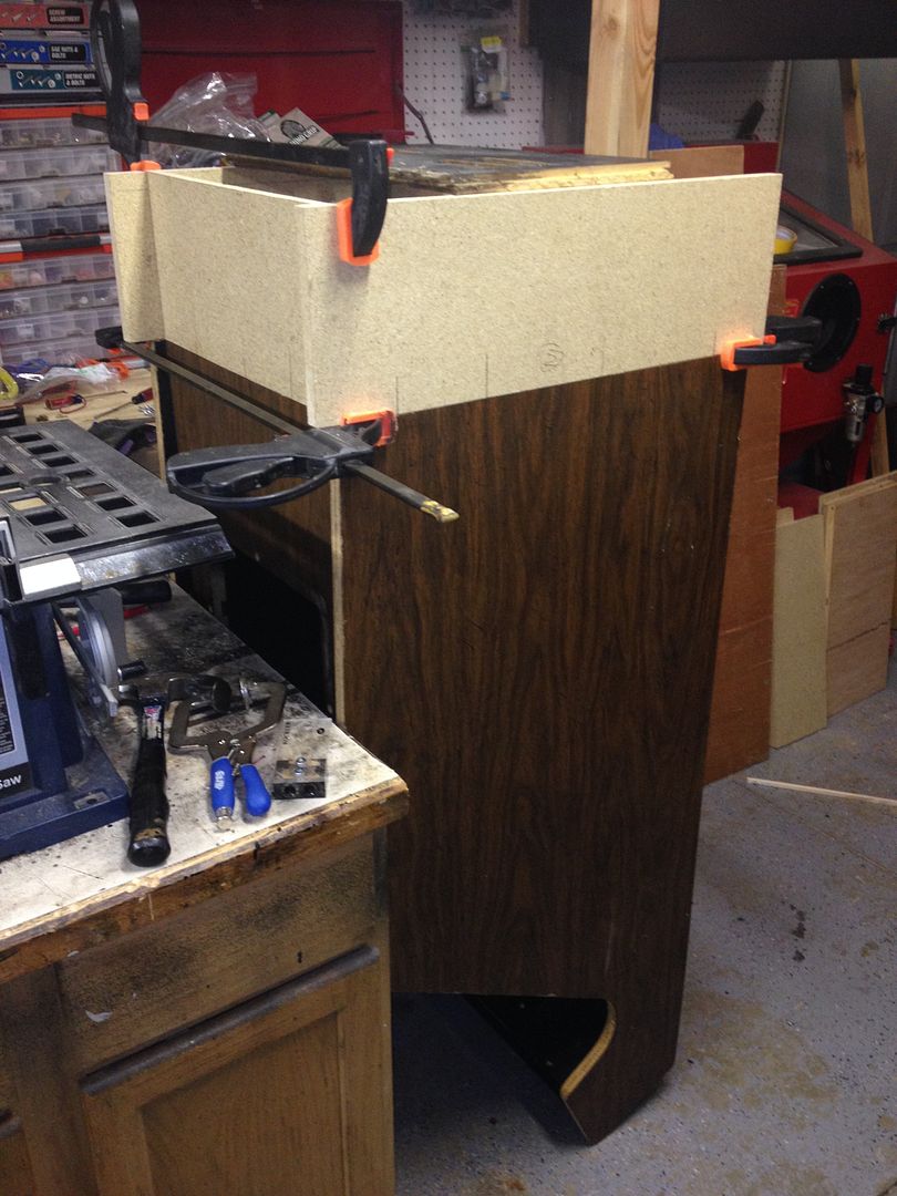

I started dowel joining the bottom 8" of the cabinet together. 1st the front panel:

i didn't drill any extra holes on my conversion, put the fire button on player 2 what is you plan on that issue?
looking good.
I'll be welding "slugs" in the control panel holes. Then I'll be drilling new holes with a hole saw. I'm waiting for the custom CPO that I ordered to plot that out.

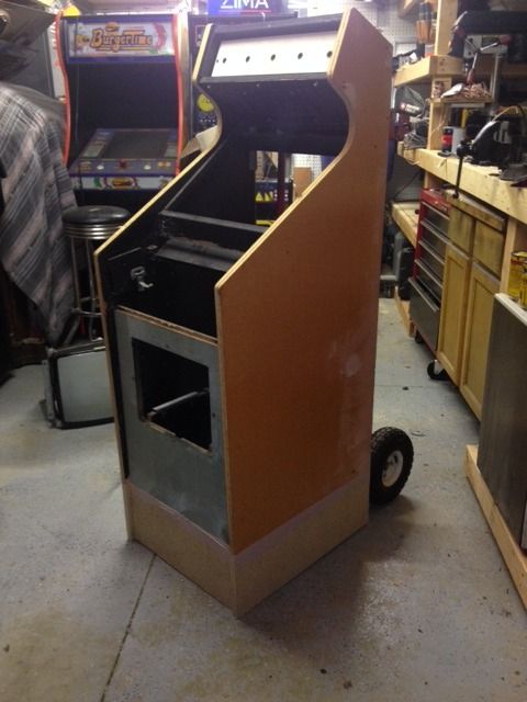

Made some progress tonight before it got dark. I removed the ratty original woodgrain vinyl. I trimmed the new bottom side pieces that I dowel jouned. I cut and added a new rear bottom lower cabinet piecem then cut a new floor and put that in. I cut 3/4 x 3/4 bracing and added that to the cabinet for added structure. Finally, I added the 1st coat of Bondo to the joined edge.

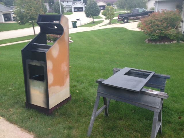

Used my HVLP gun to spray the black. It's starting to come together! I'm not sure on the outer color. Maybe black with blue t molding? Maybe white with blue t molding?
