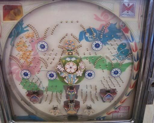

I am not sure if this is the right forum for pachinko questions or not, but I am looking at one here locally and had a couple questions.
This is the machine in question:

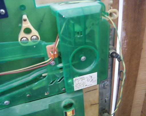

It looks like it is in fairly good condition, and the mechanisms look clean, but I do not see how to power it.
It has this sticker on the inside:
Sorry for the bad pic, but it is basically a schematic that shows a transformer putting out 9VAC, going directly to one light and going to two others through switches.
Are the lights the only part that take power? If not, where would I find the rest of the wiring?

i use old ac adapters on mine...
12 bulbs with 12v adapter, 6v bulbs with 6 or 9v adapter

The version he was looking at is gravity fed. The only things that needs power are the lights. As Caddy said just match a Radio Shack battery eliminater (or old cell phone charger) to the voltage on the bulbs and you are good to go.

Get a 9V battery snap and twist the leads around the leads on the machine, polarity does not matter. Snap in a battery and away you go... The machine uses 12V bulbs so the 9V works well and your bulbs wont burn out.
