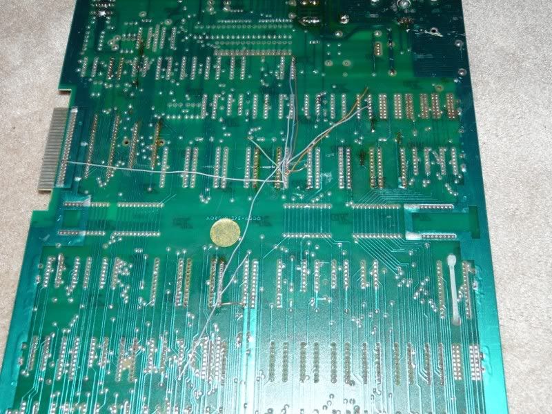

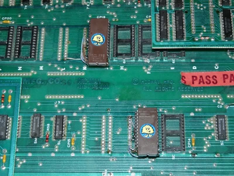

FWIW, I started running the wires through the unused "holes" for the blank sockets to get to the underside of the board... lets you keep the top clean and makes finding alternate solder points much easier.
... also ran out of wire, but found out that an old CAT5 cable had the perfect sized wire. A little more sturdy and less likely to snap after you bend it 3 times. :p
... nevermind that +5 line on Row6... when I was putting the wires through the holes, forgot about that guy. Thought about running it down and back up, but figured keeping it shorter would be better in the long run. Oversight that will not happen again. I was happy with how this one turned out, I've been thinking about going back and redoing my personal one.
Great idea Scucci. Unfortunately my board is a pac board hacked to run ms pac, so those spots already had sockets soldered in.

Yeah this one was too. That's why there are those 2 extra sockets on the far left. I hate having extra parts on the board, so I'd probably remove any extra sockets that were in the way... but that wasn't my board... so... didn't remove them. Oddly enough, mine is a Pac board, hacked to run Ms. Pac without the daughter board, unhacked enough to use a daughter board, then unhacked to be back to factory'sh (by me), then hacked again for the 4 in 1... poor board.
I don't have the NVRAM on my board, so I can't really use it (V3.x). I'd love to put in the score saves, but honestly, just being able to go back and forth between the 2 (4) games is good enough for me. Get some Pac and MsPac plus on that beast, and I'll sure as hell swap up to a 4.0 or whatever... that's for sure.
That board looks very nice indeed plus the cat 5 wire tip is spot on. Thanks
I prefer to run all the wires on top, less chance of something snagging one and yanking it off. I use the via's to jump from one side to the other.
Oddly enough, that's why I did mine underneath. lol I guess we're just worried about different types of snapping.
