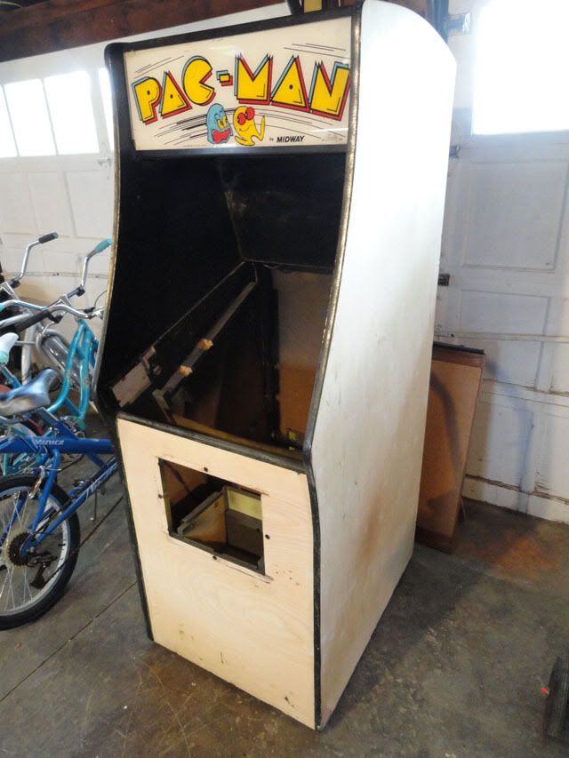

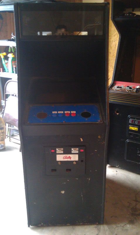

Picked up this empty cab for $20 locally. It was converted to a Bally Sente unit running "Rampart". From the looks of the numerous hacks inside, I imagine it has contained several other conversions as well over the years.
It had a thick coat of blue latex over several coats of oil based black.
I first attempted to save the art by stripping, but the numerous layers of paint made that a fruitless task.

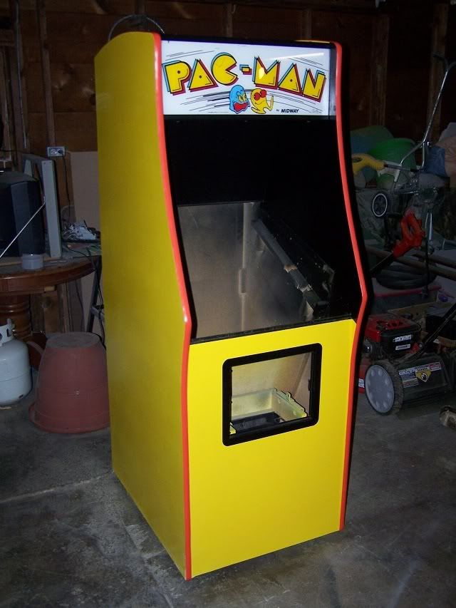

Spent several days stripping and sanding(I think I went through six 60 grit sheets on my orbital:
Though I didn't take a pic at the time, I spent a week doing major body repair replacing both front corners and several gouges. Sanded with 220 grit and applied 3 coats of Krylon white primer sanding between coats with 220 grit. Then applied by 3 coats of Krylon Sun Yellow waiting 24 hours and sanding with 330 grit between coats. Applied 2 coats of Krylon Satin Black to the interior, marquee brackets and coin door frame. Spent the evening installing new t-molding and beginning reassembly:
The finish looks much better than pictured. I still haven't assembled the dust collection unit in the shop so it's a dust pit at the moment from other ongoing projects.

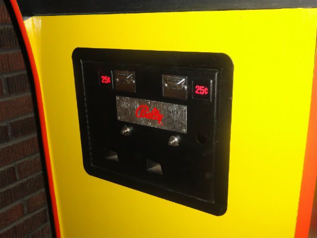

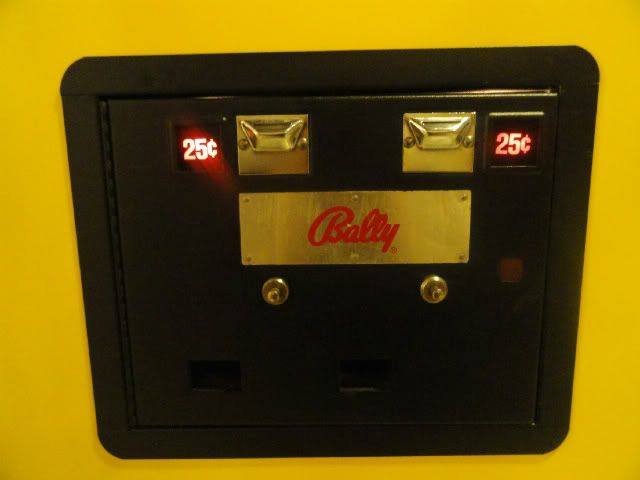

Still quite a bit of work left on this one... I still need to rebuild the lower bezel support and the monitor supports. Also need to acquire a new bezel and control panel. On the agenda for tomorrow is painting the coin door and installing the new vertical output transistors I picked up today for the monitor.
I'll likely wait 'til Spring to start the search for stencils as the Ohio weather is getting a bit too cold for any painting tasks. :)

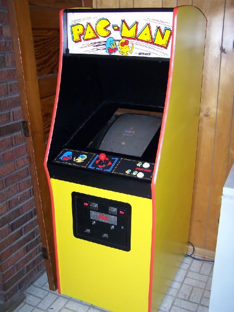

I finished rebuilding the bezel retaining piece that was missing, painted the coin door and brought the cab into the house for the winter. It is currently housed in our mud room, and I decided to build a quick wood control panel and throw Revenge of Doh in it until I get around to fixing the Pac PCB and get my newly acquired control panel(Thanks Takeman!) stripped, painted and CPOed.
I'll likely let the paint cure for the next 3 months in anticipation of warmer weather in Spring to complete the stencil work required.
Not much left to be done with this one....Need a bezel, the proper midway coin door plate and need to finish the few things I've already mentioned, but I'm pretty proud of the progress considering how hacked up this thing was inside when I got it.

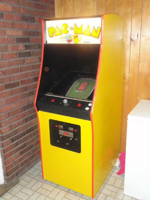

Made more progress last week, but am just now getting around to adding new pics...
Picked up this original Pac control panel:
Patched the extra holes, cleaned up the metal and fasteners. Added 2 coats of krylon grey primer and repainted with 3 coats krylon satin black.
Applied new overlay, installed a WICO 4 way leaf and cleaned up the white P1 & P2 buttons a bit..
Now to obtain a nice glass bezel and remove the scrap piece of heavily scratched lexan I'm using as a temporary bezel ;)
After that I'll just need to do the stencil work in the Spring and this one should be finished :)
