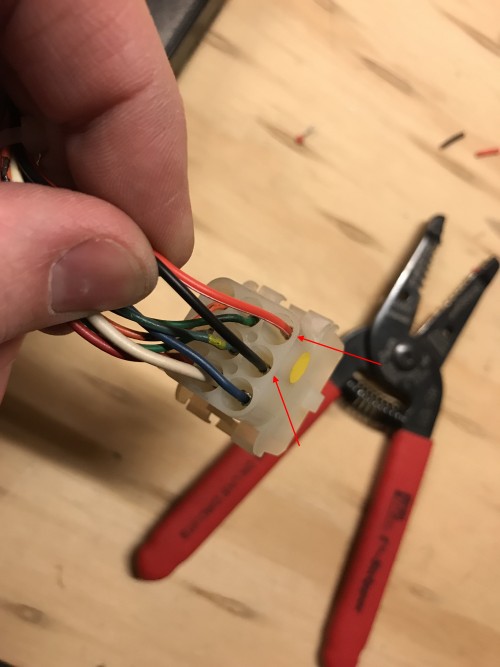

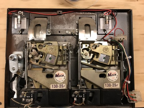

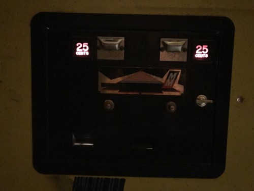

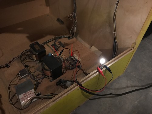

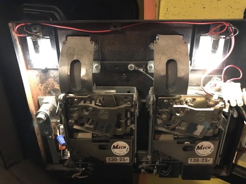

Got the coin door lights wired up to my Pac-Man. If anyone gives 2 cares, here is what I did:
Used BA9s LED Warm 12V from superbrightleds.com
And got the bayonet bulb sockets and .084 pins from arcadeshop.com
Used alligator clips to make sure I had it tested and working on the correct power supply outputs
The existing coin door molex had 2 unused holes so I ran the ground and 12v wires through those.
Mounted the bayonets behind the coin inserts.
I like coin door lights. I am happy now.
