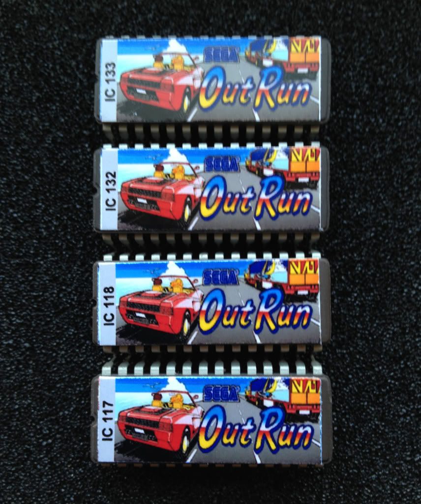

2) Are the EPROMs you're selling labeled like the ones you see in the photo on the same page? (I'd like it to be obvious in the future, by just looking at my board set, that the Enhanced Edition ROMs are installed and not the factory originals.)

2. No, I have my own custom labels (They will actually be on a new glossy photo quality label now, same picture though)

I am out of Super Caps, but I still have the eproms to make these. Here is the what the labels look like now.
