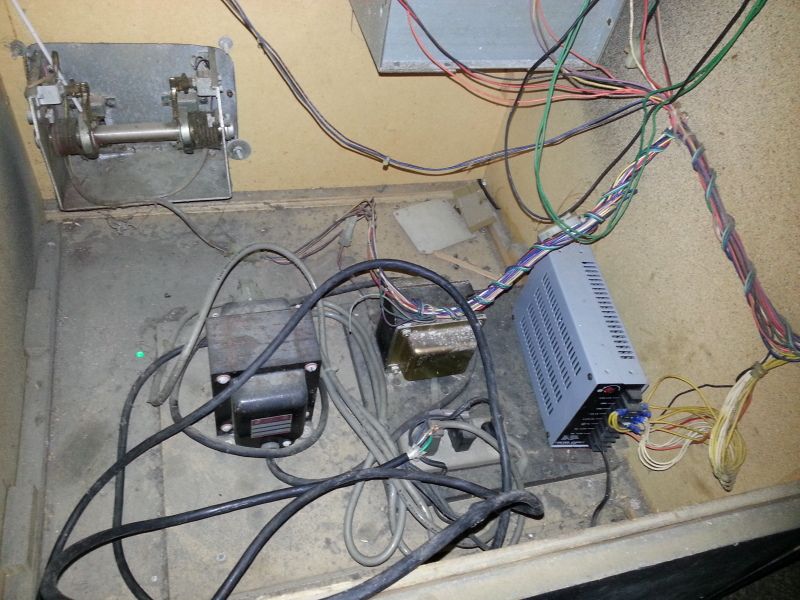

Hey guys,
I'm wondering inf anyone is kind enough to post pictures of the inside wiring of their out run please.

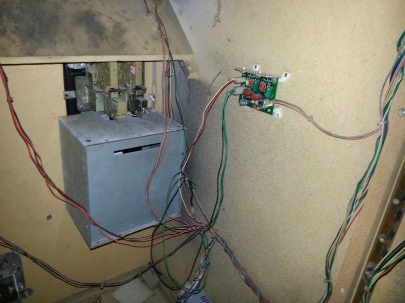

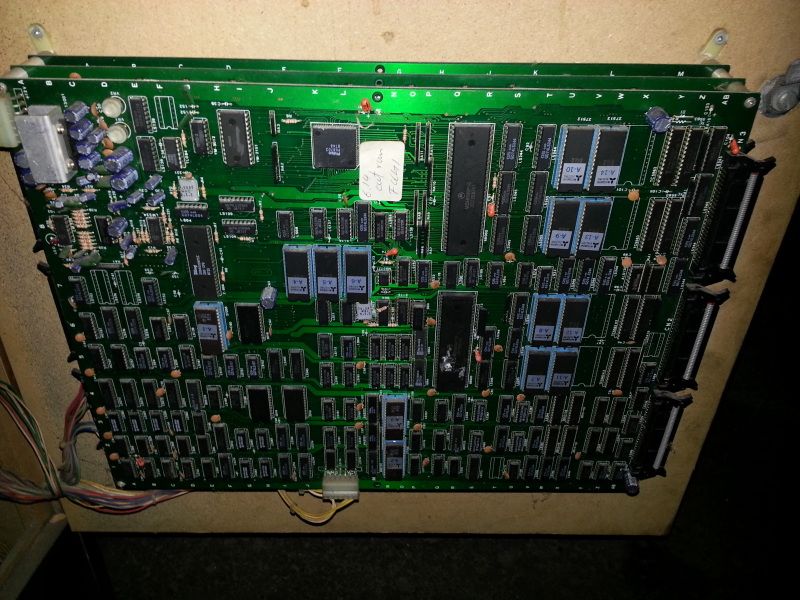

I picked up an Out Run parts cab yesterday along with a complete wiring harness and power supply from another member here as im trying to put one full working unit together. Upon comparing the two side by side, I noticed the complete parts can doesn't have the blue battery looking capacitor, just a regular switcher power supply, where the box of parts does. So I'm wondering which is which?

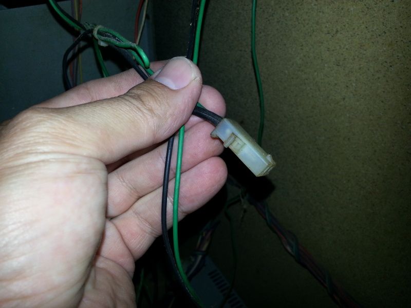

Below are some photos of the parts cab. Monitor is dead but everything else works. So the seller said.
Loose connector?
Any help would be greatly appreciated :)
Thanks in advance.
PCB looks like a bootleg to me.
The cabinet wiring is clearly not OEM. If it ever was Sega factory, it has been heavily modified. I don't think any amount of photos is going to help...
All that's needed for the game PCB to run is 5VDC. The audio amp needs 12VDC, and the shaker motor runs on like 50VDC (IIRC). Looks to me like your cab has a whole-game isolation xformer (I think they're common in Canada, a pin I imported from Canada had one too...) and some other transformer (either redundant isolation for the monitor, or perhaps a step-down for the shaker motor). The original has a switcher for 5V, and linear supplies for the other two. Looks like yours have a switcher to provide both 5 & 12 (not sure where the shaker voltage comes from).
Thanks Darren. At least this gives me some indication. The more I compare the wiring, switcher and smaller pcbs that I bought from the US, they are totally different than whats inside the cab now. Come to think of it, even the marquee is different.
I'll pop in a working monitor and fix the AC plug this weekend and see if all works and decide what to do. My other empty cab has the original artwork and is in much better shape so I might transfer everything over and keep the box of parts as back ups.

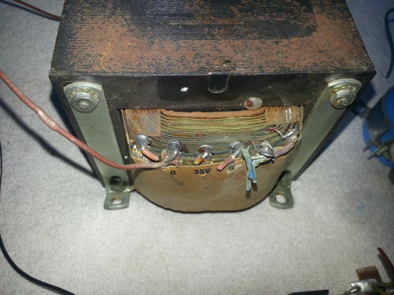

Okay, I figured out all of the wiring with the exception of the power section with the blue / black caps and transformer. Could someone please take a photo of the bottom wiring section of their out run cab? Please guys, I really need your help. I'm a visual person and need to see photos to make sense what goes where.

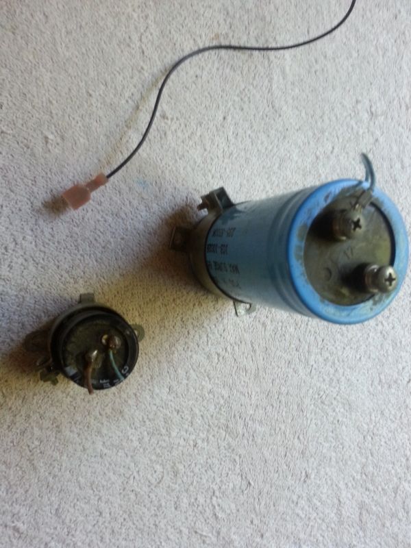

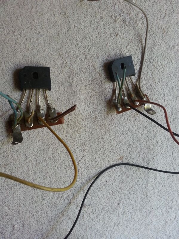

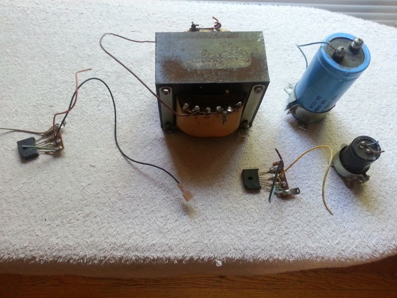

Alright, I think I have most of the wiring figured out with the exception of the rectifiers. Are these required and if so, what purpose do they serve?
Thanks in advance.
The output of the transformers is stepped-down AC voltage. The bridge rectifiers convert that to (pulsing) DC voltage. The capacitors then filter that to generate (unregulated, but not pulsing... too much) regular DC voltage. The 2 in an original OutRun are for 12V (used by the amplifier) and 50V (IIRC) for the shaker motor.

Thanks for the photo and clarification Darren. So if I'm understanding this correctly, both rectifiers read + - in the outer pins and AC on the middle pins. The plus / minus would connect to the caps (one rectifier per cap) and the AC to the transformer?
The idiot that sold me the parts went snip happy and cut all the wires so it's difficult for me to figure out which wires go where but I'm starting to make headway with your help :)
Here's what I have:
Yes, that's all correct. To add a little more detail, the + lead of the rectifier is the one with the angled corner. The capacitors are also going to be polarized, meaning + & - have to be hooked up correctly. Look for some marking on it to indicate which terminal is which.

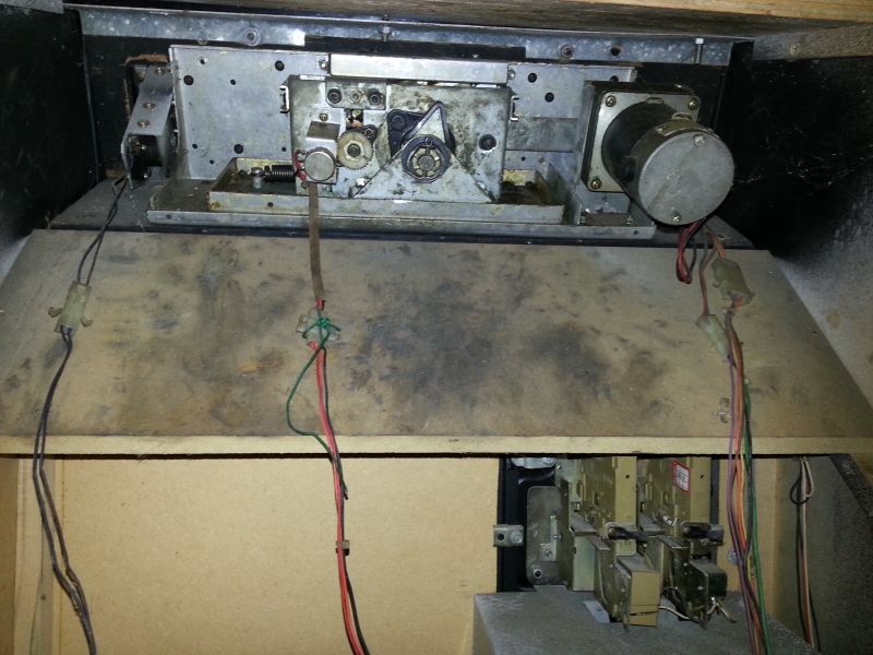

Gotcha. One more question if I may Darren. From two of the connectors that plug into the small pcb at the bottom of the cab, there are two loose wires from each one. One set is grey / blue, the other is grey brown. From reading the manual, it seems these also get connected to each of the caps or the rectifiers instead?

Appreciate the help my friend. If you could snap a few photos and post them here, I would really appreciate it. I think I have most of it figured out and Darren has been extremely helpful as well but a few more photos would definitely help. Especially a detailed photo of the wiring at the bottom of the cab if possible, the wiring connections at the control panel and fan at the top of the cabinet if not too much trouble :)

Could someone please take a detailed photo of the wiring at the rectifiers, cap / transformer? I'm starting to put mine together and would like to make sure I'm wiring it correctly.
