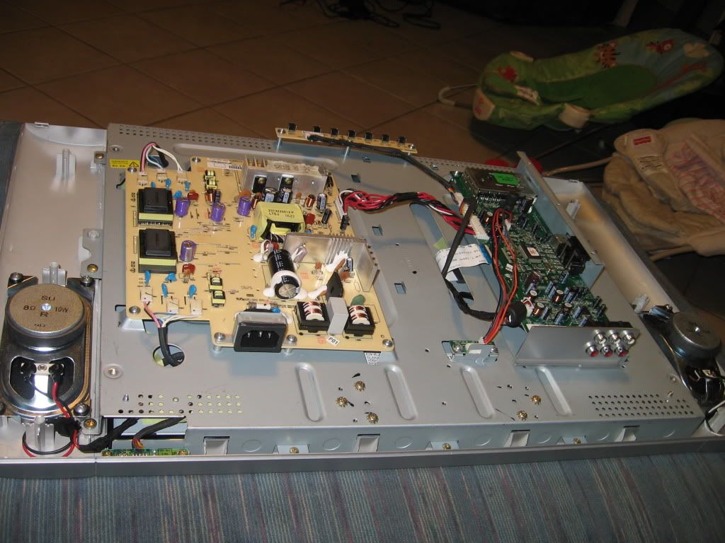

This was insanely easy to get to. Looks like the tv consists of two boards: power and interface.
The interface board and the buttons board seem to work fine. I connected a PS2 to the rca inputs and got sound, and was able to control the volume and the channel (presumably, cause the sound stopped).

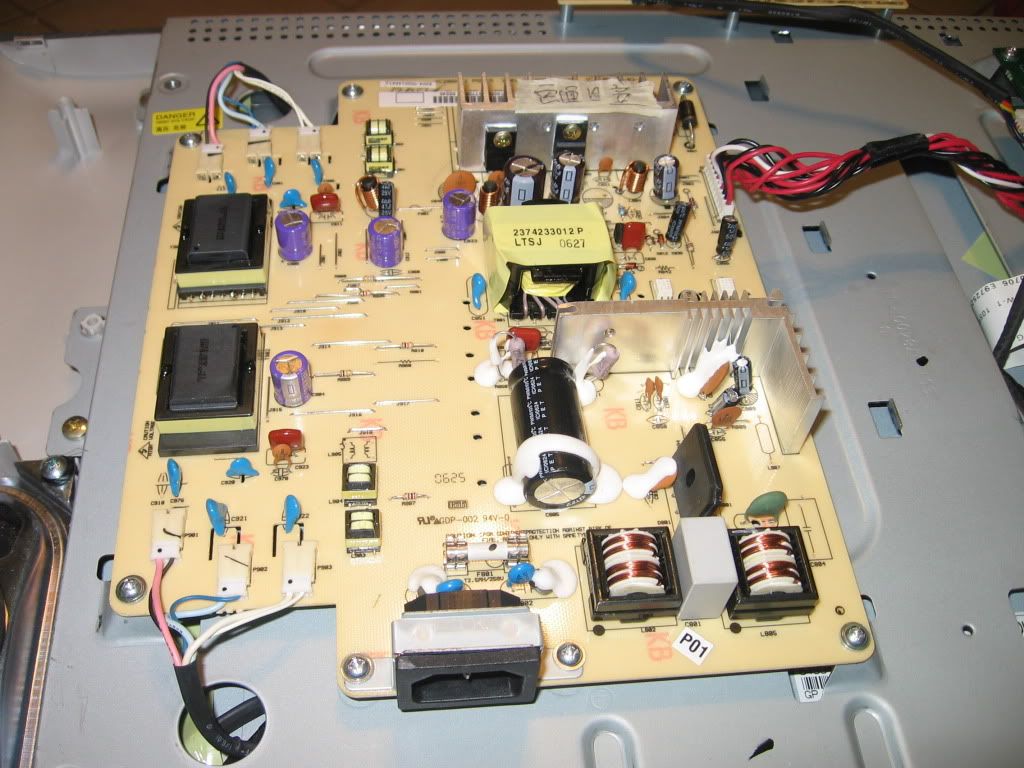

So i'm wondering if it's not the backlight power. I pulled the power board and gave it 120v but couldn't get any DC voltage going to any of the 6 2-pin plugs that i'm just about certain, go to the backlights.
So here's a pic of the whole shebang, and the power board. No caps look bulging or anything... you guys see any i should start with, or just go after them all?
http://i282.photobucket.com/albums/kk259/whoamonga/misc repairs/lcdviewsonic001.jpg
--that's the back of the LCD tv
http://i282.photobucket.com/albums/kk259/whoamonga/misc repairs/lcdviewsonic002.jpg
--that's the power board

You check that ceramic fuse right near where the power comes in? :)
fuse has continuity. i'm assuming that's good. Plus, the speakers and stuff worked. the little LED light turned green on power-on. I think that fuse is good.

So, make a list of all the caps, order 'em, swap 'em, then try again?
quick question about those backlights...
it will be supplying dc voltage to the lights, right? And somewhere in the 3-6k range? I'm not sure i can measure that then... Either way, those lights ain't comin' on. could those high voltage things go bad outta the box, or just go with caps first?
I'm just tight on a first investment...
I'm not a 100% sure of that voltage measurement but I seem to recall the little LCD Screen on a Beach Head 2000 being driven at 4k or so. As far as I know its DC. I think what craps out on those is the inversion circuit itself. Could be bad caps too but I dont think so.
Matt
what is the inversion circuit?
But if I'm not getting any voltage coming out of those 2-pin connectors, would that indicate inversion circuit, or cap?
The inversion circuit takes low voltage (probably 12VDC) and steps it up to the 3K (or whatever it is) that the LCD backlights need to operate.
Matt
i believe if this was nib and doa, mabye youll get lucky and find a missing trace somewhere or missed solder connection, bent connector header pin, etc etc
could also be the light was just bad or something too...
