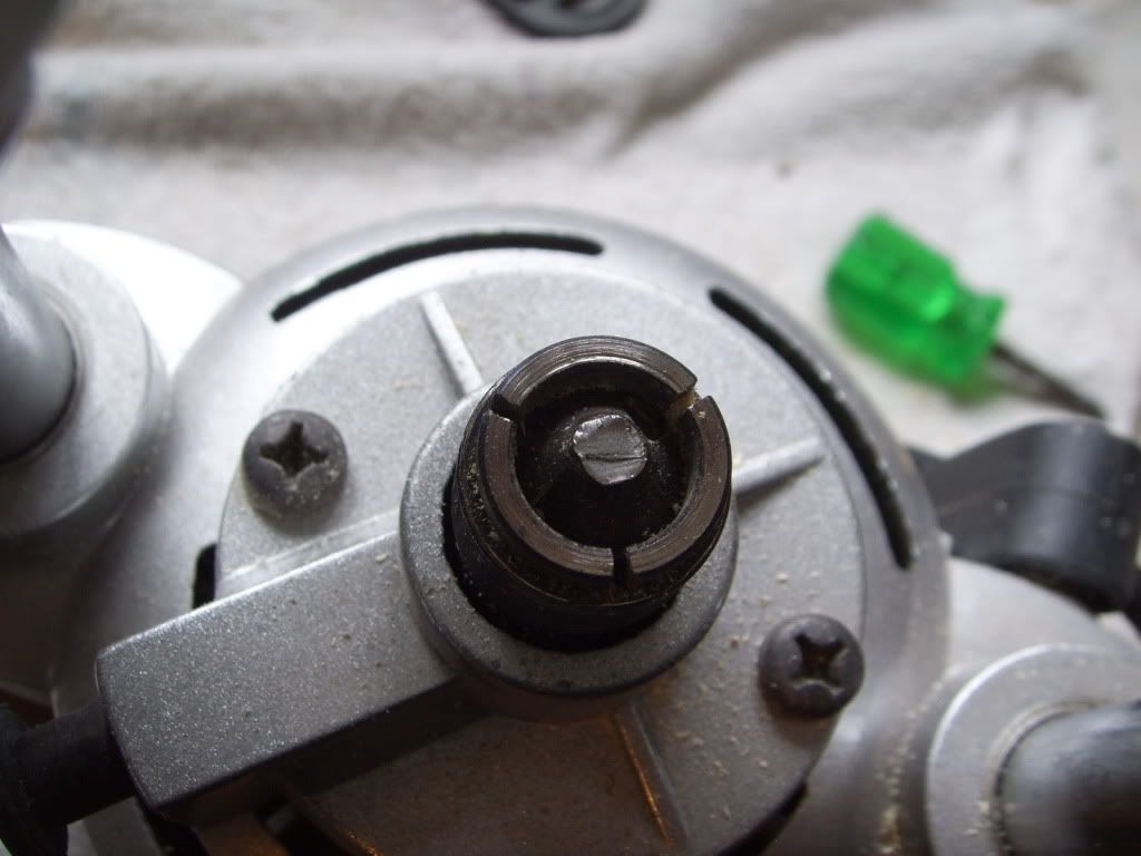

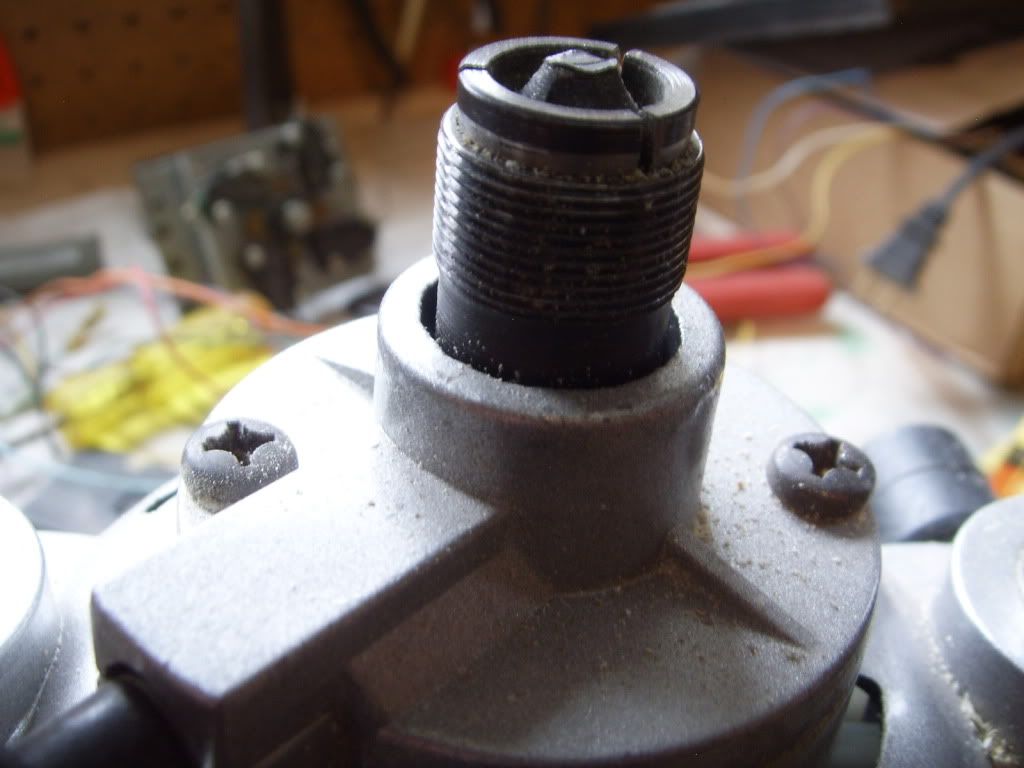

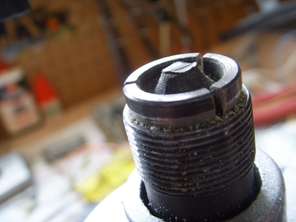

I removed the nut, but can't get any leverage to remove the broken bit. Do I need to remove the faceplate that surrounds the collet, or just pry the bit loose or what? I have never broken a bit before and this bitch ain't budging right now. Help.
Will do. I feel like a helpless jackass at this point.
Do you have a cutting torch? Ok, hold the torch between your knees and grab the collet with one hand and use a screwdriver to move the.....JK!!! Waiting on the pic.
Need to see pic since it is a 1/2 bit maybe carefully epoxy a nail to the broken bit with something like jb weld. Using cold / heat and lubrication to slowly coax the broken bit out? Before you try pulling it out, can you tap it in a little further first? That would help getting it unfrozen with the most leverage.

The bits are removable as are the collets, as this came with 3 collet sizes, 1/2", 3/8" and 1/4". I wonder if the collet backs out counterclockwise? Time to find and consult my houseboy Manuel.

YMMV, but collets with caps nuts are usually free floating. They are tapered as is the tube seat in the armature. As the nut pushes the collet backwards, it is compressed around the bit's shaft. Your problem is not so much that the bit is stuck in the collet, but rather that that the collet is stuck in the tools armature. I would try heat (be careful not to damage the motor) and penetrating oil. Also, sometimes a quick rap (inward) with a small hammer will fre things up. Be light handed with the hammer as you're do not want to pound it in deeper, just break the metal-metal interface for a moment so it can slide out.

Try spinning the collet. If you have a pair or smooth-jawed vice grips, you can use those to compress the wings and spin it back and forth while pulling straight out. (serrated jaws might dig in) You'll need to lock the shaft, either with the wrench or the push button, whichever your router uses. Otherwise it'll spin with the collet.
You might want to hit it with Freeze spray. Perhaps the collet will shrink more than the shaft. Cycle between cold and heat. Don't look like there is a lot of the collet sticking out to get a hold of. Got a vice? Vice Grips? Gentle taps with a hammer after freezing may help too.

Lock the armature with the lock that should be built into the tool then grab the edge of the collar thats sticking out with some pliers. Dont pull out hard on it, twist it while lightly pulling out. The twisting motion will break the taper loose.
Another thing you can do is tap the broken bit down inside the tool a little. This wont work if you bottomed the bit out in the collar when you installed it. Try twisting first then second option.

Got it. I tried to use the button lock and twist with a vise grips, no dice. Then I tried to lever the collet straight up and out of the router with the tip of my vise grip jaws and the whole thing popped right out. The bit pushed out the back and I am back in business. Thanks fellas.
