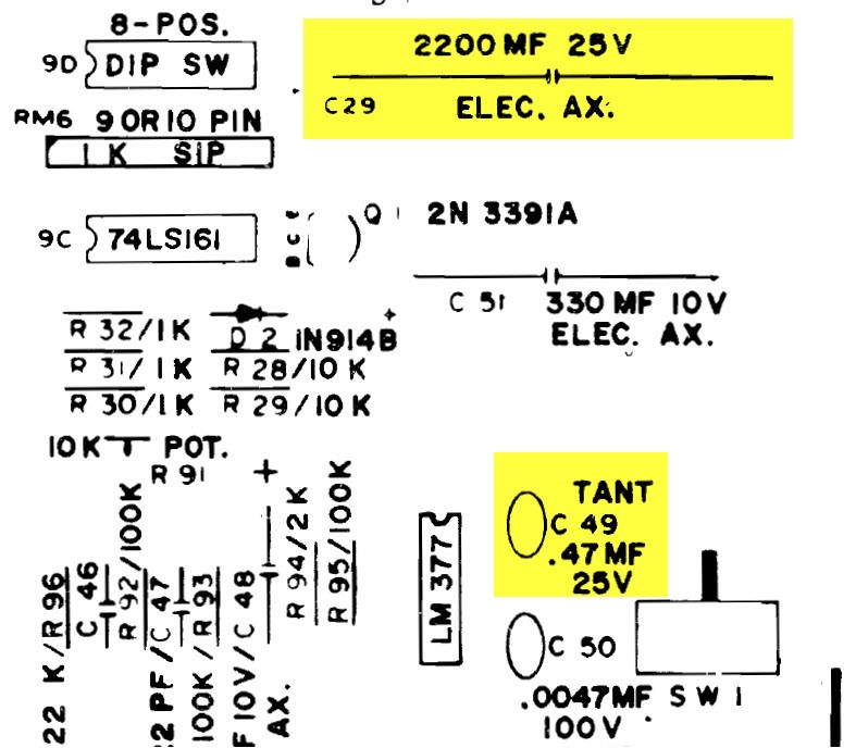

Oh, and one other possibility is that C29 is shorted. With the game off, measure the resistance across C29.

Oh, and if the resistance across C29 reads low, it could actually be C49 or 11A causing it as well (they're all in parallel).

I can't find C49 or 11A on the board...?
It's on page 88 (out of 99) on the pdf schematics online at: http://arcarc.xmission.com/PDF_Arcade_Bally_Midway/MsPac-Man_Parts_and_Operating_Manual_(Jan_82).pdf
If you own the real deal, it's on page 7-8. I highlighted the two capacitors you were looking for... 11A means 11 amps.
