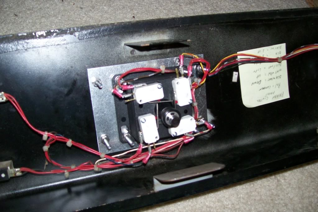

So, I am restoring my original Ms. Pac-man cocktail cabinet and I decided I wanted to add a multi board. My plan was to use all the original parts (joysticks, 1p/2p buttons) and not modify the original control panels so I got a set of multi 9" control panels and overlays from arcadeshop.
Now the problem is I want to use the original joysticks and the new control panel doesn't have mounting holes in the correct locations. I could try and drill them out but they are square for the carriage bolts. Does anyone make an original large footprint to newer style footprint adapter plate? I have seen several plates out there but they all are aimed at newer joysticks in older cabs so no one mentions if they work the other way. Another problem is the p1/p2 buttons dont fit, but I can file away at the new CP holes and get them to fit.

My original joystick footprint: ~ 5"W x 2 3/4" H
New control panel joystick footprint: ~ 2 3/4" W x 3 1/8" H

After taking apart the control panels it looks like the original joysticks will not fit unless the top portion (with the plate) that screws in to the bottom portion of the joystick is taken off and replaced with another piece that is smaller. Otherwise its just too big and runs into the two buttons on the right.
I doubt there is an adapter that screws in directly to the bottom portion of the joystick with a newer smaller style footprint so now I guess I'm going to have to buy a new joystick. I think I want to stay with the leaf style but with the smaller footprint, anyone have any suggestions?

Well I thought I'd post an update on this. I replaced the CP and everything is installed and working!
I ended up replacing the joystick with the REPLACEMENT JOYSTICK FOR MS PACMAN / GALAGA & MIDWAY GAMES (JS-MP) from twistedquarter.com
I have to say I really do like the leaf style joystick better than the new one with microswitches. Does anyone know of a leaf style joystick that matches the newer footprint of the JS-MP?

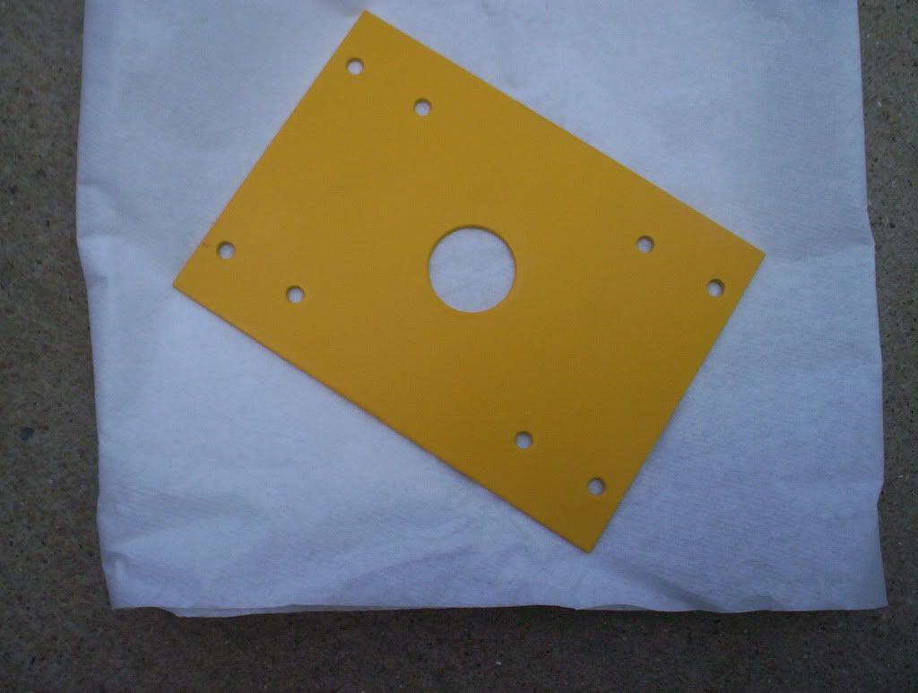

There is just nothing quite like the original pacman joystick. I have made adapter plates for the old pacman cabinet for the newer joysticks, but there is no reason you can not use this same adapter to go new cabinet to old joystick. my adapter plate is flat, unlike the ones you find elsewhere that have a bend in them. It will only require that you cut the 8-32 bolts to an exact length (so it does not hit the original pacman joystick) and then use some 1/4" washers as spacers between the original joystick and the adapter plate (this provides clearance for the nuts on the blots that are mounting the adapter plate to the control panel). Each 1/4" washer provides 1/16" gap, so one at each corner should be enough since the pacman joystick has an offset as well.
