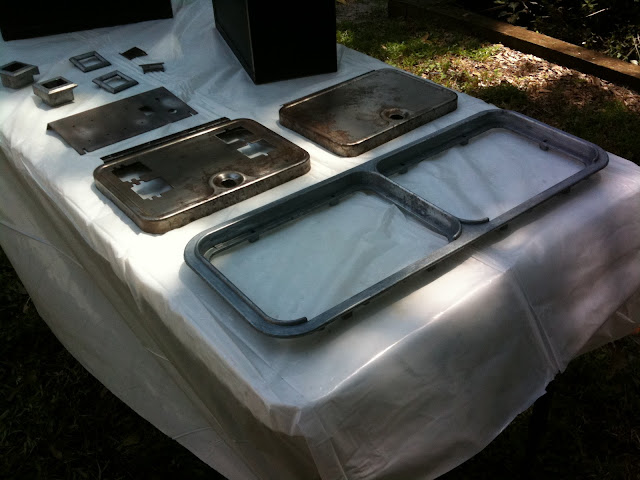

Another update here, I finally got around to doing the coin door this weekend. It's my least favorite thing to do, and I suck at it. I made an effort, to slow down and try to do a better job. Three hours went into stripping the paint, and that was using Klean-Strip. I used Rustoleum textured satin and no primer. The finish turned out well enough, better than any I've done so far. Lowe's had replacement screws for the coin doors and coin box control panel, these were all rusted. The coin box and test switch panel got taken apart, sanded down and painted too.
